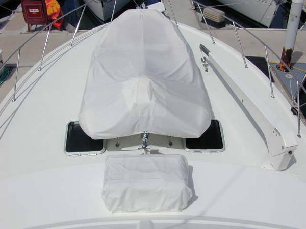

    Just purchased 1990 46 post need to know where to mount
    davit and pole

    Once you determine the area where you want to put the load (dinghy, etc.) the most important factor to determine is weight distribution for both the Davit (some are fairly heavy) and what it will lift, not only at rest but also as it lifts whatever out of the water. Next question is where it will be anchored. You don't want the pole coming through the middle of the master berth for instance. I'd recommend having a professional installer go to your boat to give you ideas. I fact for most larger davits I'd recommend having a professional do the job.

    Depends on your layout. This one's master stateroom is forward. The davit post is in the guest stateroom closet.

    We're talking about a closet. There's only so many options. Pick a corner. I think this one is the inboard forward corner. I can't remember ...and if I'm not mistaken it runs down to the stringer - which is preferable.
    Why on earth do you need 1,000 lbs capacity? 600 lbs will lift a fully outfitted 11'6" center console Novurania RIB.

    Yes. Guest SR has upper/lower berths running athwartships which allows post to be concealed in closet. If your berths are L configuration the post would be exposed at fwd bulkhead between upper berth and headliner.

    I have a 91 46 with the 600lb Nautical Structures mounted on the Port side in the the rear master closet corner. I put a late model 9' AB RIB with a 20hp honda 4 stroke and a St. Croix bench seat. I am close to the weight limit with this rig. My davit is the older manual lift, no hydraulics. I had to build an extension to the davit in order to clear the bow rail. Wish I had the 1000 with a hydraulic lift and extension. I hope your's is hydraulic.

    Thanks I wish that was right. Add on the St. Croix stainless bench seat, a battery, anchor & some chain, fuel and the crazy rig I made out of stainless to lift her and I get an extra 150 or more on the boat. Then I built a SS extension on the davit to clear the rails that weighs another 60lbs.
    The hard part is calculating the lifting weight at the tip of the extension. The extension adds 2 more feet to the davits length. If I dont pull the fuel and loose stuff out of the boat before I pull her up from the water, I can stall the winch. I will weigh the boat in a week or so with all the stuff to see the dead weight but I dont know how to calculate the actual load on the davit with the extension. Thanks
