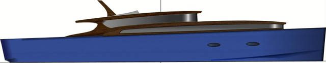

    Tar PIKNIK
    Inspired by the Hinkley picnic boats, this litte runabout is my absolute favourite of my concepts. Here is the original profile developed in Corel Xara.

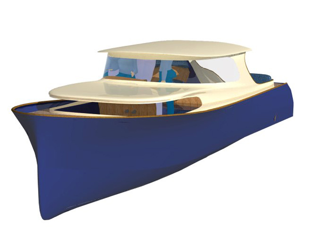

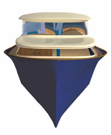

    PiKNIK 3D
    As you may have seen on my other posts, I have moved towards 3D to develop these conceptual designs. And as you can probably work out from the initial profile the design is a litte too elegant. I soon discovered that in 3D the head room wasn't going to be very good.
  4. JonS
    JonS Senior Member
    Feb 7, 2005
    362
    Maybe instead of a run about, the top drawing at least, can be adapted for a larger craft, where the overhang at the back of the saloon is the maximum headroom, and by having a split level open helm based on the higher level, maybe?
  5. tartanski
    tartanski Member
    Nov 5, 2004
    116
    Hamburg, Dunnon, Buzios
    Thanks for the feedback Jon, that really what i was looking for, I will of course look at that possibility, so far I have a slightly higher version as run about and As you suggest I could make a larger yacht , perhaps similar dimentions to the new Dolphin yacht from Ferreti group.

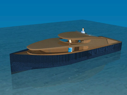

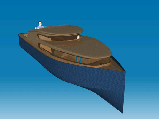

    3D model update

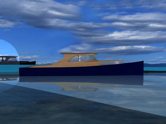

    Just to reassure you that this project hasn't completely stopped I have added a couple of renderings of the CATIA model. I have had to redo the whole thing due to new software, which was in a way a training exercise for me. I am determined to take this project to its logical end, i.e. all 3D details, structures, systems etc. However as many of you probably know its very easy to get stuck in the conceptual phase, which to be honest is where most of my interest lies. More feedback expected , along the way of course.

    Re design in respect of the original Hinckley design
    After much delibration I have decided that I was straying to far away frm the original Hinckley design, and have therefore modified the lines siginificantly to reflec the original style, (Aft tumblehome, flared bows, and long classic coach roof lines)
    What do you think?

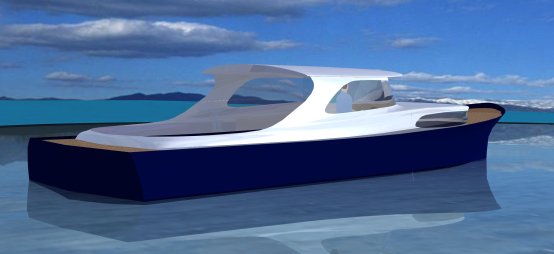

    Having further studied your renderings I do not think the problem is with the windows but more likely the profile of the superstructure andthe reverse sheer in the crown of the cabin. Or maybe in how it blends with the cockpit fairing.

    Agree
    Yes I agree I was not satisfied with the whole profile so have already changed it. Albeit it now is even more of a copy of the original Hinkley!
    However due to the maintenance (I am guessing) I can not upload any attachments to show the new profile.

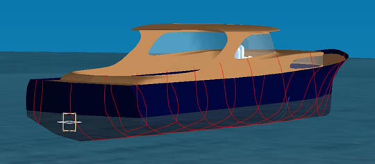

    Renderings
    Attachments!

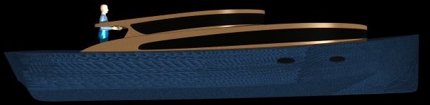

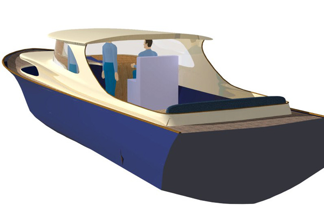

    More Renderings
    No Major update here as I have had to spend the time re-modelling all the surfaces to optimise my model.
    I have decided to stay with this general form and the main dimensions will remain more or less consistent. However I have noticed that the hull is perhaps not deep enough, or that the coach roof is too sleek. Or perhaps my German Manikins are just too tall.
  19. KCook
    KCook Senior Member
    Jun 24, 2005
    1,160
    Phoenix
    Almost as if the height of the floor in the cabin changes, depending on whether the view is from the bow or stern.
    Kelly Cook
  20. tartanski
    tartanski Member
    Nov 5, 2004
    116

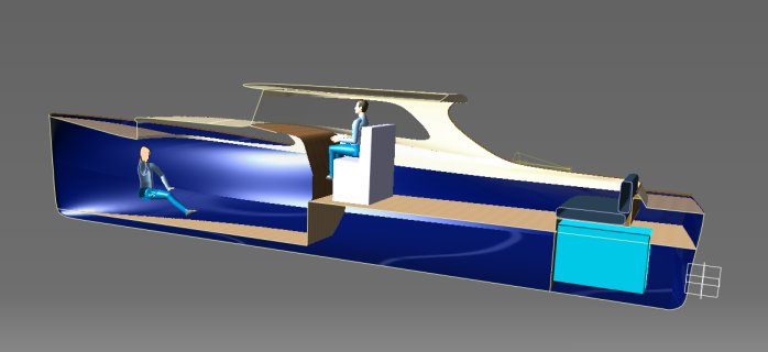

    Section Cut
    Well the floor of the cabin does not change but the rendering before did give a weird effect due to too high refraction settings on the glass.
    As you can see the effort vs result curve for modelling the interior has got me, OK I haven't worked on the interior at all but I realise I need to start with a 2D plan before trying to fit it all in. Where is my copy of Freehand!
