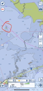

    Did that trip in April with 4' draft and Pascal is correct. One additional warning...give very wide berth to Sprigger Bank Light 5....very heavy shoaling, stay 500 yards+ to NE of it and you will be ok.

    Thank you. Where is Sprigger bank.? Can’t find on Navionics.
  17. Pascal
    8,546
    Bay side on the yacht channel

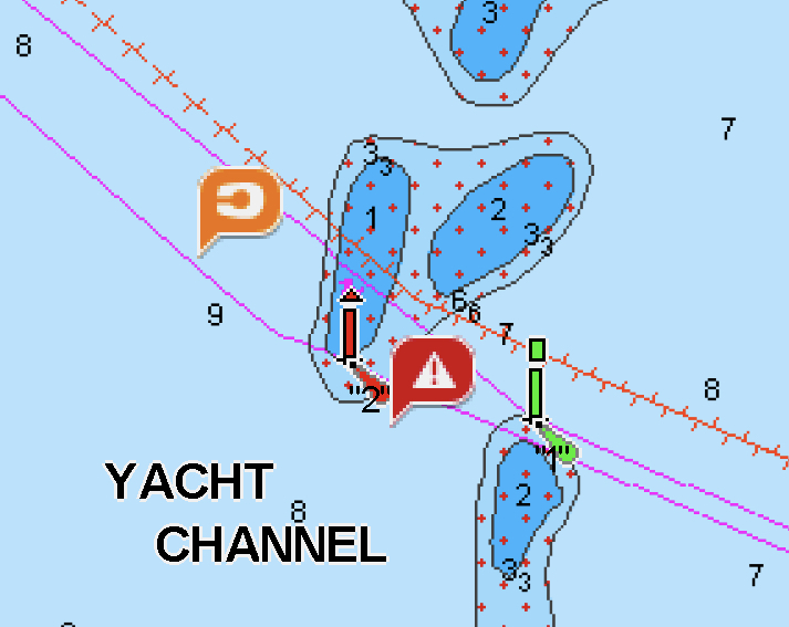

    There is also that sketchy looking dogleg 4.3 statute miles SE of Sprigger bank.
  19. Pascal
    8,546
    I haven’t used the yacht channel in a few years but that dogleg isn’t bad as long as you split the markers evenly and slow down so the bit doesn’t squat
    I know that some people have gotten in trouble over the years there by leaving the green to stbd and the red to port when Northbound
    benjay likes this.
  20. benjay
    benjay New Member
    Jul 14, 2022
    30
    SE Florida
    Good intel. It looks obvious on the chart, I’m concerned about shifting sea bed and all that. Plus, if I’m driving pods with fwd facing props it’s a different predicament to that if I had a keel or outboards.
