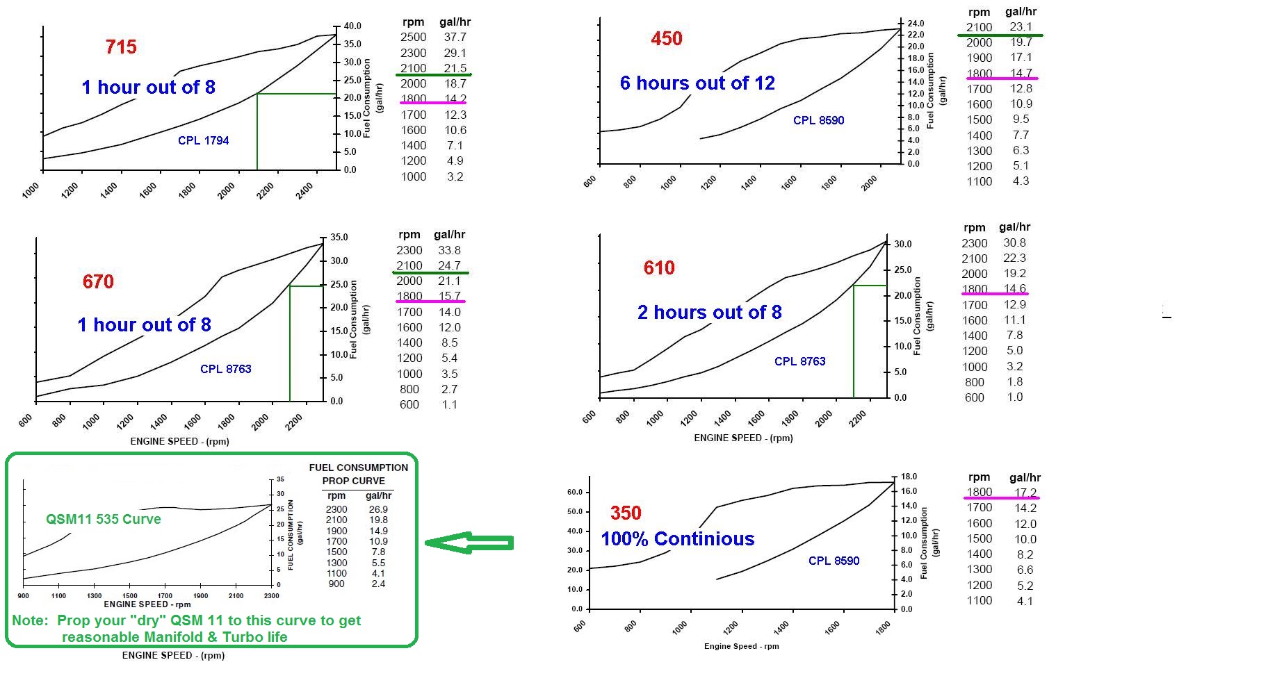

    This might help you out. It's you GPH at certain RPM's That I have been following. Yes I'm a little slower but what's the hurry?
