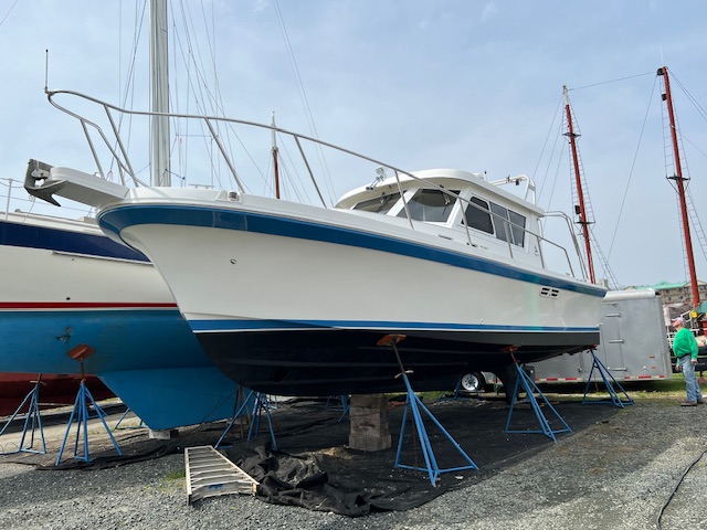

    Is this a good engine?
    I have owned boats with Yanmars, Perkins and Westerbeke diesels, but never a Cummins, never heard of the 450 Diamond Series, but now eyeballing another Bahamas Cruiser with this single 450.
    The big hitters for me would be quality, easy service, easy parts availability and all over user-friendly.
    The boat is an Albin 35TE, never been on one before but it looks good so far…(pictures only:cool:)

    I believe that is the big 8.3L / straight 6 engine.
    I managed a boat that had twin 650s and ran perfect.
    I luv that engine.
    @450hp, it should last near forever.
    Survey it well. If it was taken care of, you will like it very much.

    Step 2 is more pictures and (hopefully) detailed maintenance records, then more pictures, then a trip North for a buyer’s inspection, then and only IMG_7483.jpeg then, a good survey with a haul out and a sea-trial.

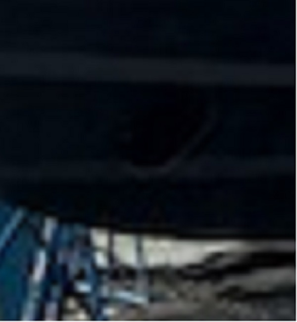

    The seller said it has a bow thruster, but I don’t see it..
  6. Capt Ralph
    13,444
    It has a thruster. Black hull, thruster hole in the shade.

    Yup, see it now, you have good eyes..
