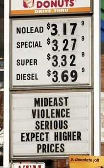

    The main problem with big blocks is they are gas hogs. In this economy if you buy one, you won't be able to go far and if gas gets any higher you will never sell. Get diesels.

    My mind fails to understand the logic. :rolleyes:

    Check marine fuel. It's usually the other way around.

    Add about a buck each to those prices and you'd be in California.
