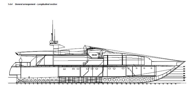

  7. K1W1
    7,427
    You can also measure the air draught off the GA if you have one showing a side profile making allowances for your current loading condition and any changes since the drawing was made IWO masts, antennas etc

    Ft Lauderdale
    Yes, You are going to look through your General Arrangement drawings and hope you find the numbers to tell you your air draft height. What if you don't find them there by chance?
    Next, How do you learn the bridge heights along the way to know if you are able to complete your mission or not?

    7,427
    Your GA should be drawn to scale if it is a proper drawing so the measurement can be found using a scale rule.
    As for bridge height, they are often shown on Amiralty Charts or can be found in the Pilot Book for the area as suggested above

    Ft Lauderdale
    Exactly. With the GA drawings, we can take a ruler (or dividers) and take measurement of the numbers running along the bottom of the drawing and use the measurements to discover the vessels air draft.
    Then with the proper charts you will have the bridge height info and then you should be ready for accomplishing your journey while clearing bridges with out issue, in good theory at least.

    7,427
    Those numbers along the bottom will probably be your frame spacing.
    The drawing should have a scale on it you can use instead of counting the frames, if it isn't drawn to scale using your method could produce a fairly good error value.
    It is also important to remember that air draft starts at the waterline in the loading condition at the time you calculate the airdraft. If you are at he end of a long journey and light on fuel and water you might have a few hundred millimetres difference on the average yacht.

    Ft Lauderdale
    Those numbers along the bottom read 1 through 37 (you cant read them in the picture) and I know the vessel is a 38 meter build. I was thinking that those numbers were reading the meters but then they might be reading the frames.
    But then the frames might be spaced every meter so then it is doing both.
    How would we know for sure?
  15. K1W1
    7,427
    Personally I wouldn't be surprised to find 1m or 39 inch spacing on a vessel that size.
    Use a scale rule, if you can find a scale that matches the numbers you are in business.
    Drawings can sometimes be produced by pasting various images onto a page, the paster could stretch the image a bit and then your errors begin.
    A proper drawing should have a box in the lower right hand car that shows, drawing name, scale, revision and date of revision, shipyard name etc.
    When using one that you are not sure of the pedigree of always take the cautious route and measure the drawing yourself,especially if it was printed at Office Depot or similar, this doesn't just apply to GA's.
    There have been a few disasters over the years where scales have been mixed up, mm and inches mixed. The Hubble Telescope is one that springs to mind.

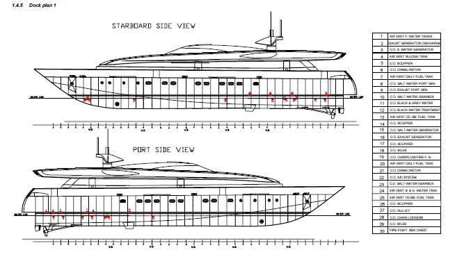

    Hi Capt
    I would have to guess if your drawings are not what they built then you have the wrong drawings to be trying to calculate your air draft with. How do you figure out what your air draft is?
    I do know these Docking Plans here have been used by shipyards so they could place there gear accordingly for haul out (the actual paper drawing, not this cut and paste copy). K1W1 mentioned about cut and paste being a potential error causing issue with stretching to make calculated measurements with so I would use the conventional paper drawings and not this example below.
    Please keep in mind, I do not know how Captains know there air draft, I just know a lot of times they do not. Just recently there was some articles floating around where a sail yacht hit the 17st bridge in FT Lauderdale. And if you do not know that bridge, it is the bridge that every yacht has to clear to enter or leave FT Lauderdale. And if you do not cross that one properly... I would just quit, you wouldn't have to fire me or anything.
