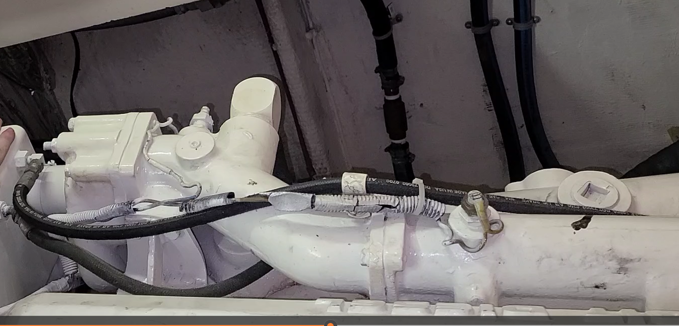

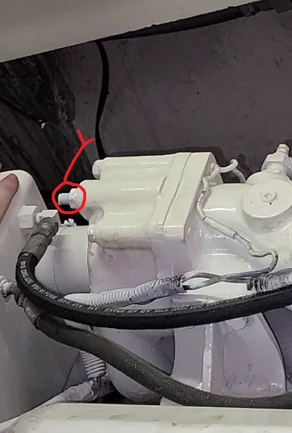

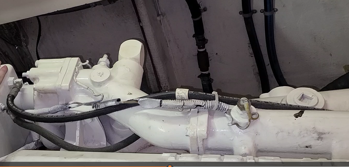

    See attached photo for thermostat

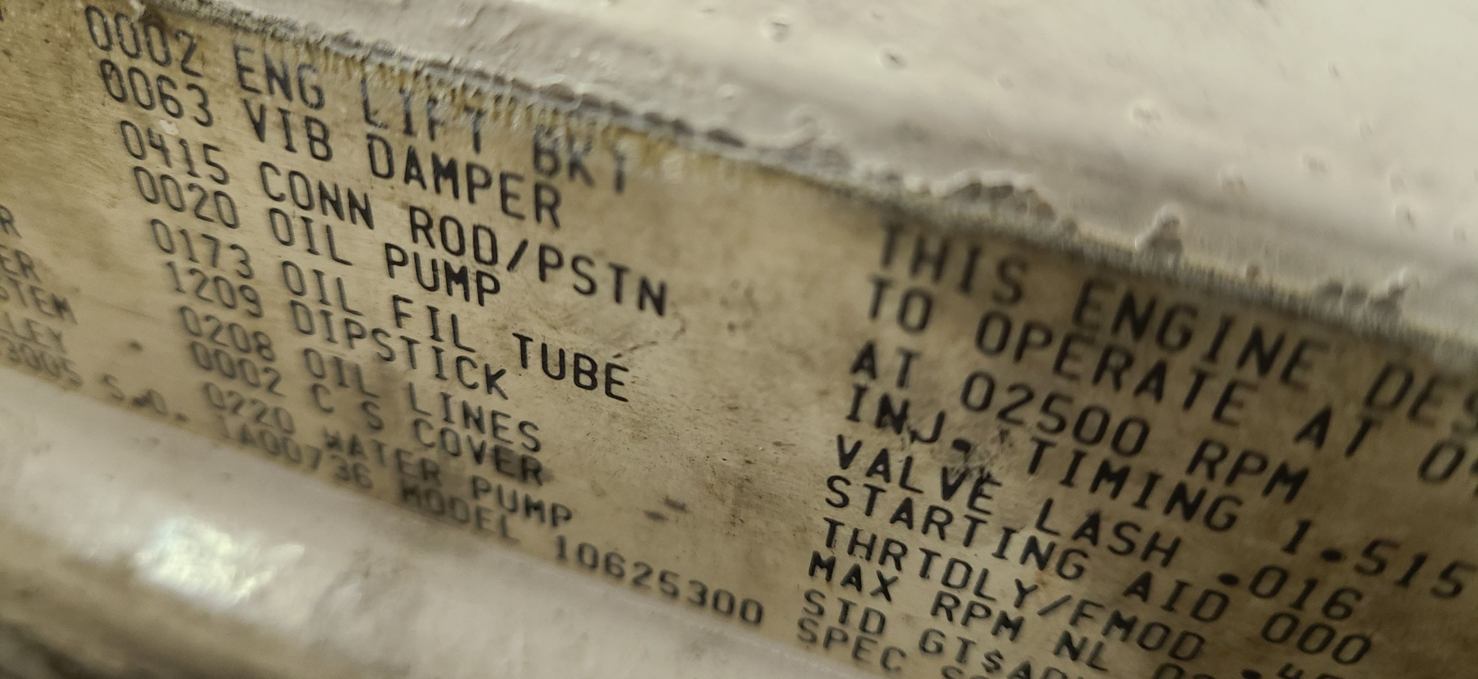

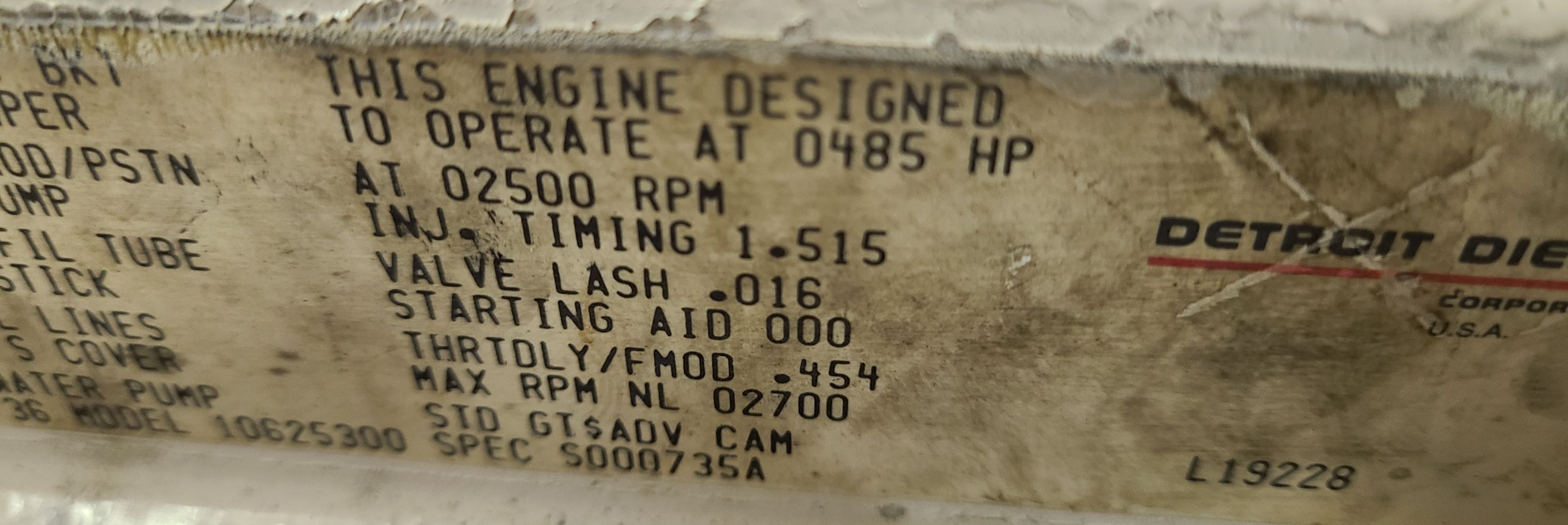

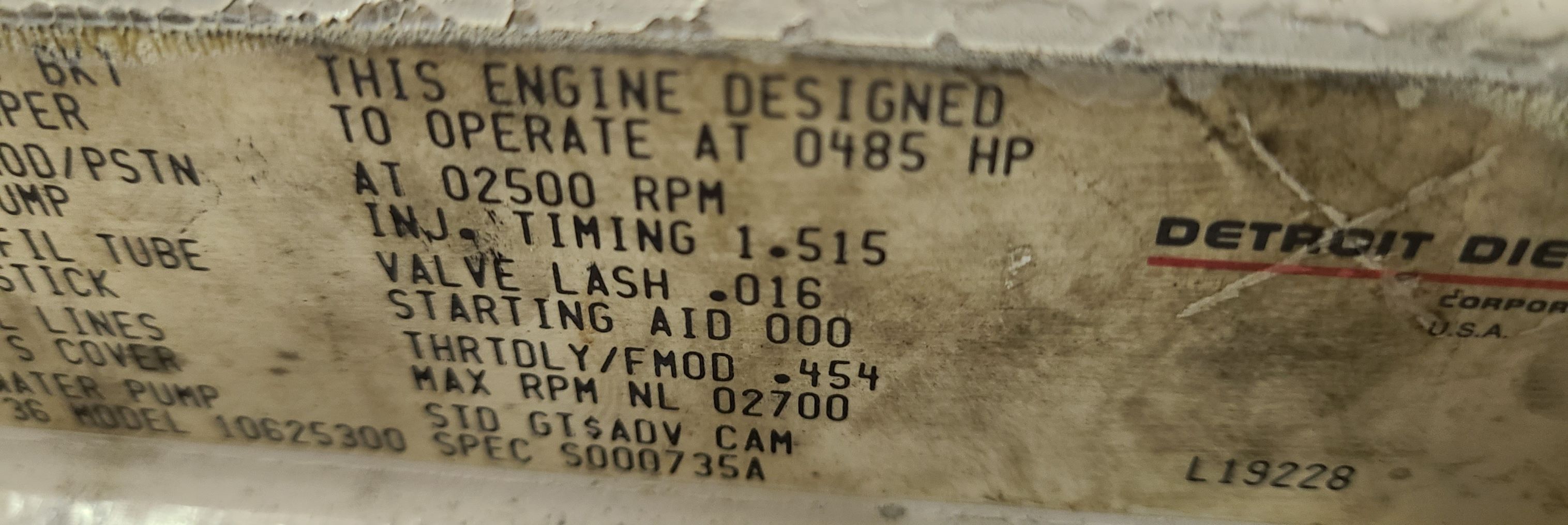

    Not sure what horsepower tune is, but the engine is rated 475 hp @2500 rpm
    Not sure what the marinizer is, the heat exchanger?
    Everything is white, but when the previous owner had work done, they repainted some things.
  7. Capt Ralph
    13,270
    Then 475hp is what the engine is tuned for. This tells us you also have a high out put engine with by-pass blower.

    Uses different plumbing, heat exchangers and maybe different thermostat housings, also.
    Have have a fair idea of what you have now. I'll start looking thru my notes. Get back to you with some ideas later.

    Coolant venting.
    I am sure any trapped air has long ago worked out.
    I assume your coolant recovery system is working fine including fresh 7lb pressure caps (part number 6410879).
    Just in case ya wanna know;

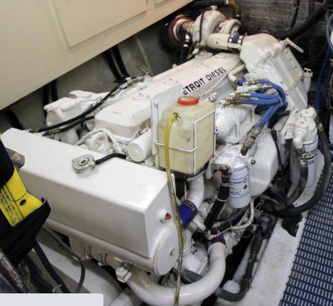

    There are a couple of air trap locations on this monster.
    Those lil hoses in the picture should vent the turbo and back of the exhaust manifold and fixes the big air trap issues.

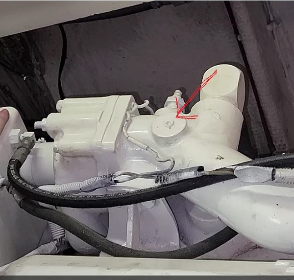

    The last air trap may be at the thermostat housing.

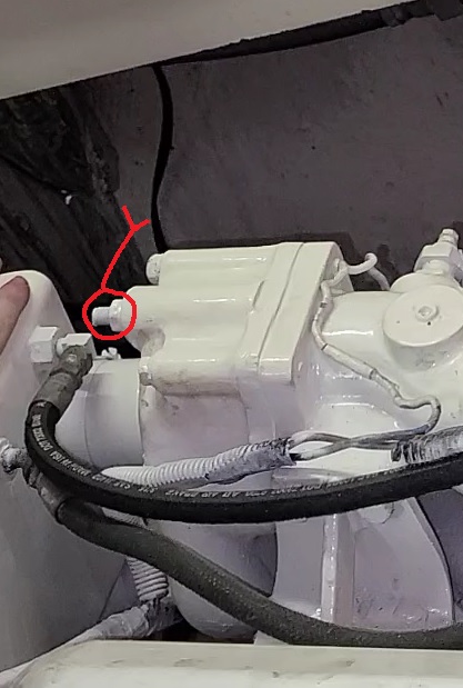

    Crack this plug to vent the housing.

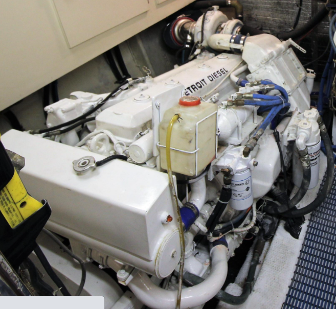

    I call it straight up, see picture. I put new coolant in the port engine last year and in the starboard this year. I used Walmart Super Tech prediluted 50/50 Heavy-Duty Extended Life Antifreeze/Coolant. I have wondered if there is air trapped somewhere from the coolant change. You can see from the paint on the screw you mentioned it s still covered in paint. The manual does say to bleed the air after changing the coolant, but I did it at the screw directly to the left of the one you pointed to, closer to the coolant tank.

  13. Capt Ralph
    13,270
    The picture in post #6 made it look like a Pan-Cake install.
    DDC did this to lower the install height for some customers.
    You have the Real Macoy, DDC 485 HP, 6-71 TIB.
    Sweet.
    Should also be 2 plugs on your raw water pump that may use zincs.
    You pulled this screw??

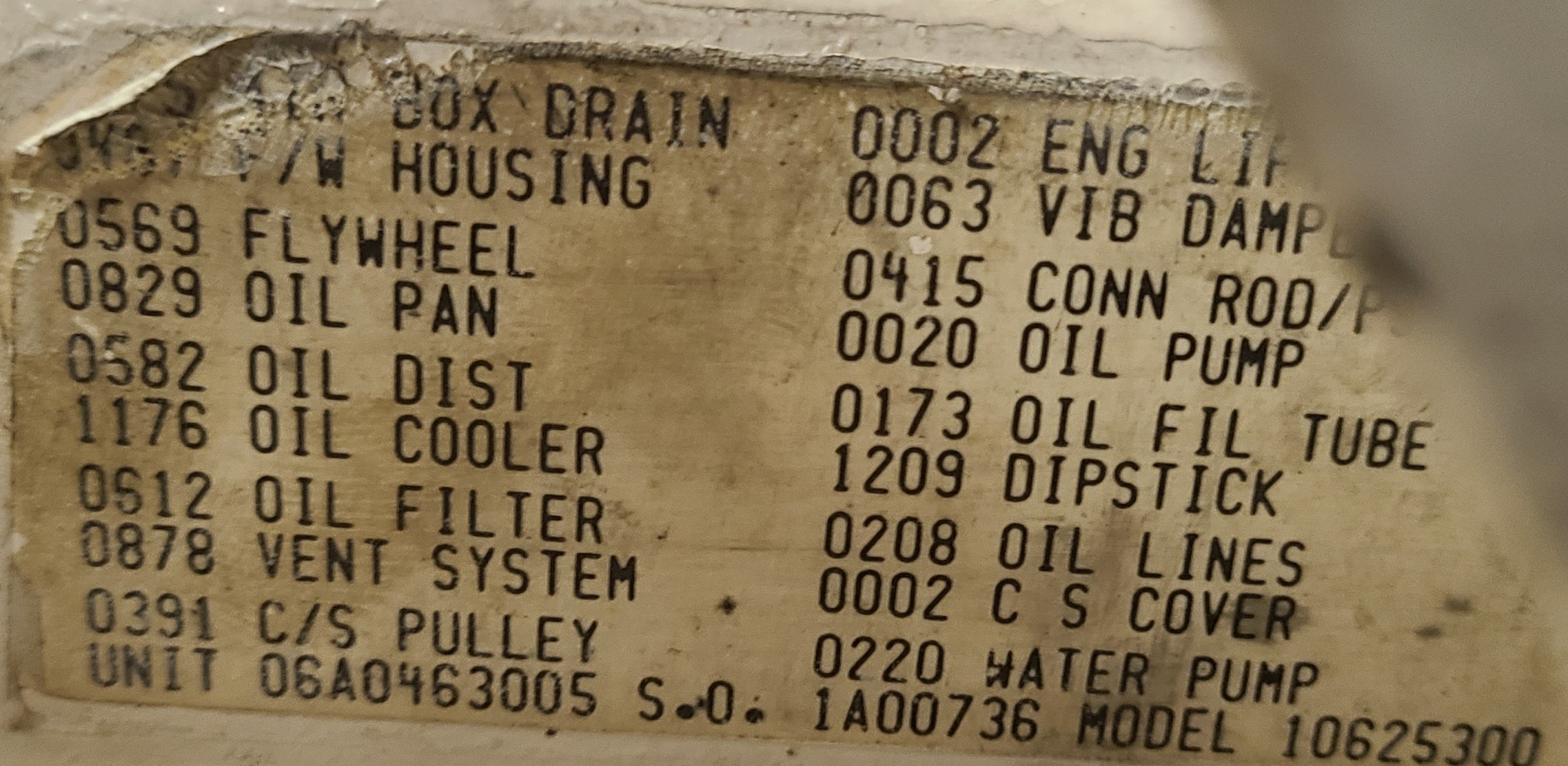

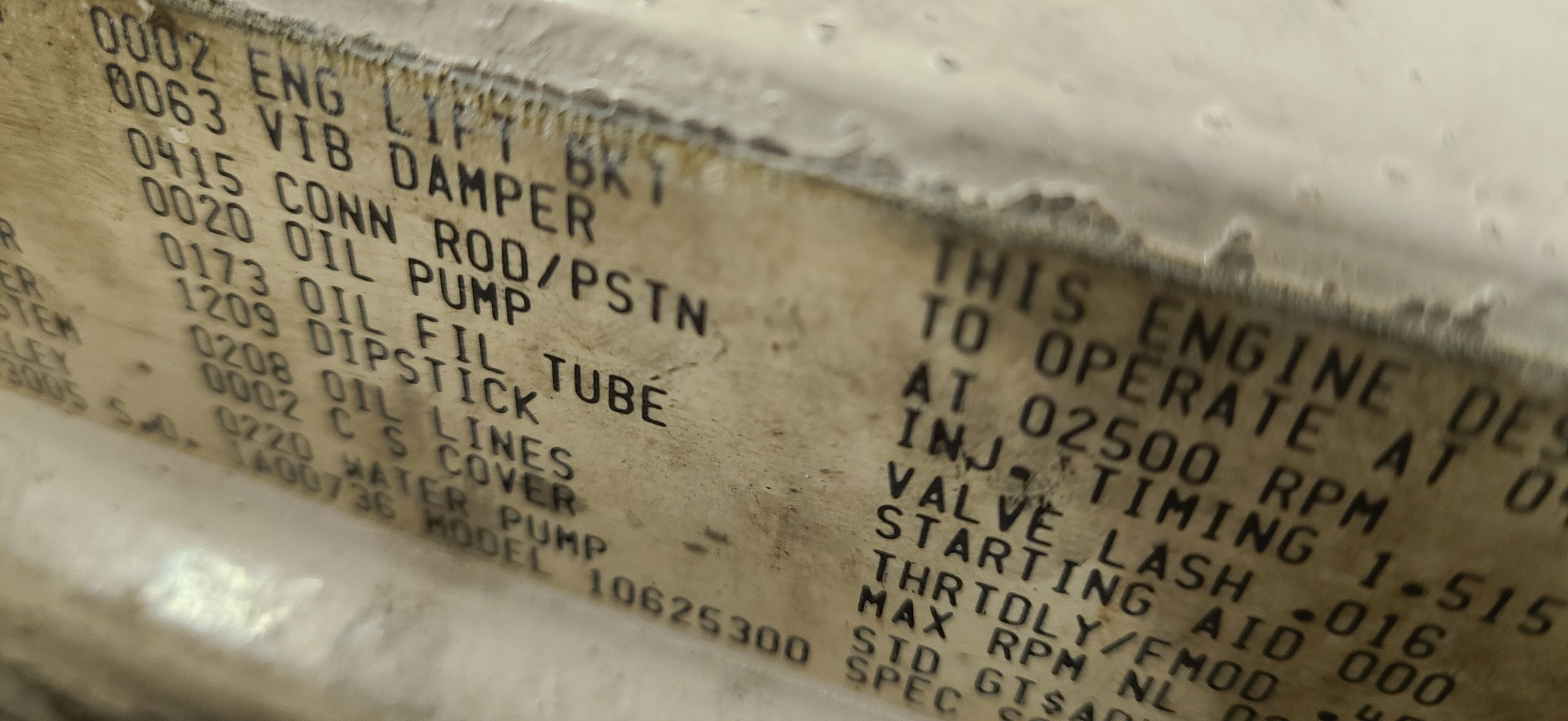

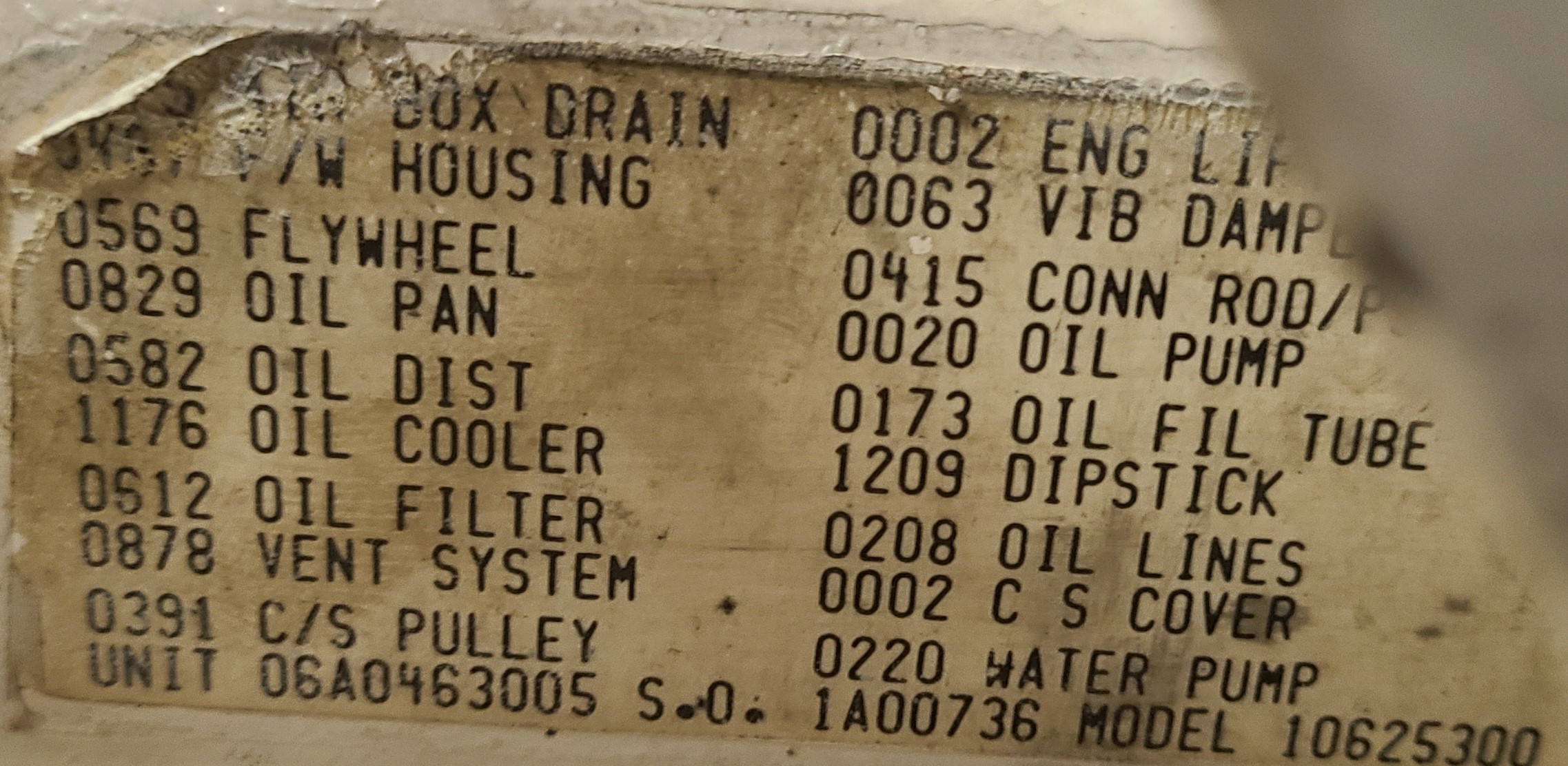

    It's a J and T 671. Same as my 471s low profile J and T engines. White paint is usually J and T , Covington would be silver . A least when it comes to Ocean.

    485 HP tune was DDC.

    If you call Johnson and Towers Mt. Laurel NJ, ask for Jeff in the parts dept. , and nicely ask him for the engine start up and test reports for your engines. He will need your model/unit numbers and serial numbers for each engine. Assuming you have J and T engines, which I think you do. Also helps to buy some parts from him , to encourage him to search the paper archive file for you. I have my reports from them going back to 1980 start up at Ocean. It's a wealth of information.

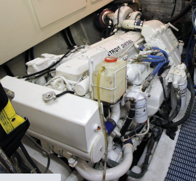

    Yep, that's my engine.
    That's the screw on the starboard engine that I bled. The port engine has a drain cock there.
