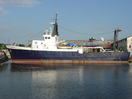

    This is an ex-Canadian fisheries vessel that I became involved with.
    The living spaces aren't too difficult; the engine room and peripherals will get your wallet's attention, though.
    What are you doing down in 'the hole'?

    Nice vessel. Like me, you'll have your hands full (and your wallet empty :)
    As to the engineroom, or should I say palace... I'm not going to touch the main engine. It's in excellent shape, recently overhault, ready for thousands of hours more. I will have the prop blades adjusted to make it more of a 'cruising' prop instead of a 'trawling' (as with fishing) prop.
    I'm taking out one gen set and will replace it with 2 Onan sets. I also have to add water makers, air/co, waster water treatment , SCUBA air compresssors, that's about it. Some of this equipment may go under the guest cabins.
    I looked initially at getting a smaller engine (6cyl. instead of 9) but there is no way I can ever recoup that investment. Of course the switchboard will need some upgrades and we may replace the Halon system with something more ozone friendly.
    As you probably know, it's not difficult to spend money on a project like this; buying the ship is the easy part.
    I'll have a lot of work done in Colombia. That will save me mucho $$$ and the offer good quality .
