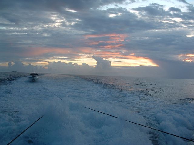

    K1W1 pretty much hit all of the important points.
    If you have not set it up before, you'll want to check with someone who has and insure that your cleats and rigging are correct. Getting set up is one important part, and then getting off / going in tow is your next critical stage. Take a little practice, and care.
    We do it regularly. This is a 32' center console Century in tow.
