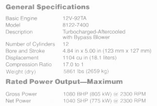

    I'm confused if my existing Detriots are 1150hp or 1080 hp. There is conflicting info. I can find documentation on the 1080hp but coming up empty on 1150 hp 12v92TTA. Anyone shed some light here?

    The different DDC HP numbers are SAE flywheel HP and propeller shaft HP.
    It's the same engine.

    Heras a snapshot of the 12V-92TA:
    1040 is the shaft horsepower. There was an 110hp DDEC Version at the end of the production run.
    The big benefit you will get is a tremendous weight savings:
    12V-92TA = 5,861 lbs. dry
    CAT C18 = 4,101 lbs. dry
    MAN V8-1200 = 4,278 lbs. dry. They also have a de-rated 1000hp version that is 3,925 lbs. if you don't need to go above 1000hp.

    The spec sheet I have indicates the 12V-92TA dry weight is 4,895 lbs dry. Not sure where you found the 5,861 lbs you indicate? I attached the sheet I have but I cannot confirm it matches my engines exactly. So I'm assuming roughly 1, 600 lbs weight saving from engines (800# each) plus another 400 lbs for batteries, chargers, and other stuff that can go away.

    I had a Detroit Diesel 12V-92TA spec sheet as well, maybe a little older, it may have also included the large factory gearbox in the 5,861 lbs.
