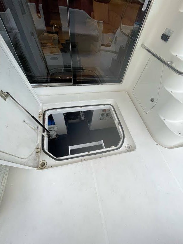

    In this pic, you can see the drains. One under the transom door in the corner.
    Are these clear?

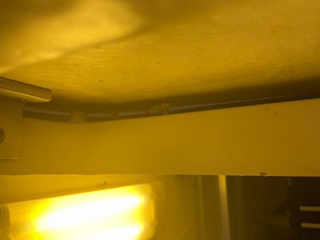

    Looking up from below, Should be good sized gutters.
  8. Capt Ralph
    13,436
    Ah, but from here, light coming in. I can see where wash water from a hose can easily come in here.
    Looks like something in the gap holding the lid/deck up.
    What is that L bracket doing their also?
  9. Capt Ralph
    13,436
    Compared to the bottom of the saloon door, I would say that corner is up.

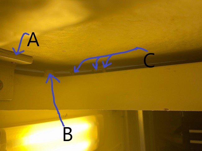

    Been thinking about this.
    Lets go over this picture again;
    A is a deck support to keep the deck rigid in front of the saloon door.
    B is a spacer that supports the deck also and keeps the mounting bolts from pulling the deck to far down. These are all around the mounting flange.
    I have no idea what C is.
    Could be something keeping your deck from coming down correctly and letting that light (water) in???
    Rob Greenwood likes this.

    Thank you all for your continued help! @Capt Ralph that diagram you made is definitely helpful. I have a feeling this cockpit floor was lifted up once before by the previous owner a long time ago and for some reason it was never put back perfectly. I would like to avoid removing anything that is currently holding the cockpit floor in place (like that L bracket). A few of you advocated for using “closed foam strips”. How exactly would I be able to use these and what are they? Thank you all!
