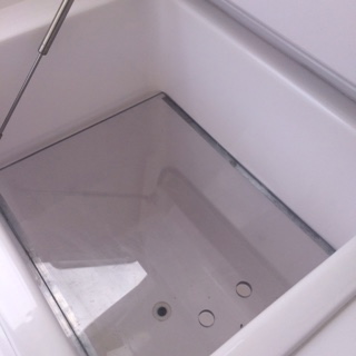

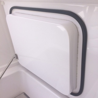

    Hi Skip,
    My cooler tops are insulated and fit pretty tight. There is also a clear plastic cover that is about 8" from the top. It kind of ends up that stuff stays hard frozen in the bottom and refrigerated on the top. Tom IMG_1207.jpg IMG_1206.jpg
  11. Capt J
    14,530
    That's always the case unless you creat airspace between the sides so that the air can circulate from the bottom to the top.....Most bait/chest freezers won'd keep stuff on top frozen.
  12. BoulderGT3
    BoulderGT3 Senior Member
    Jun 19, 2014
    168
    Ftl
    If I take the clear divider out it freezes everything solid and holds it.
