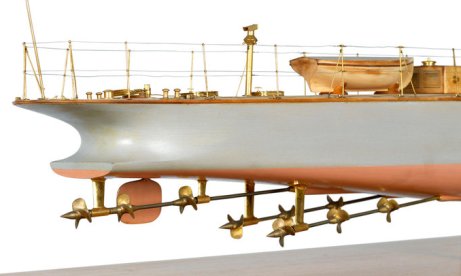

    The added cost and complexity of shafting, seals, and reduction gearing very quickly outpaces the relatively minor benefits that might accrue to a recreational vessel using contra-rotating props.
    There are (or were) exceptions:
