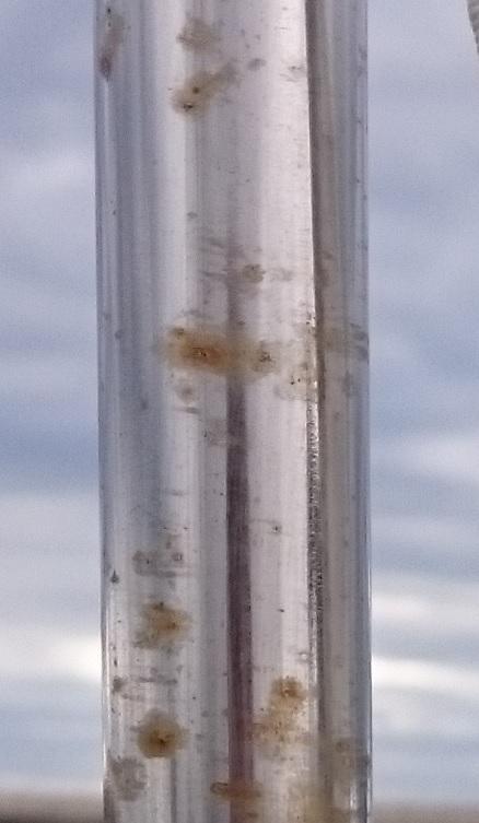

    So I would like to ask more advanced sailors, which products do you use to clean this dirt ?
    Some recomends me M3 but would be great if get your opinion about that.
    Cheers

    A little difficult to tell the material in the pic, but if it's stainless steel or chrome it looks like time for Never-Dull. I don't generally recommend Never-Dull as it's an abrasive. Once you use it you'll need to use it more and more. However once pitting and scratches start you're stuck. Once using Never-Dull keep the stainless coated in wax or something like Corrosion-X or Plexus to keep moisture out.
  3. Capt J
    14,532
    That's not dirt, it is the stainless tarnishing/rusting. Use Collinite metal wax on it as directed with t-shirt material and polish it out. Can also use 0000 bronze wool with the metal wax on it, but I don't think it's that bad.
  4. Capt Ralph
    13,443
    Once cleaned, wash it after use. The wonder of stainless is lots of things don't stick to it and sheens away.
    Salt is NOT included in the lots of things. Pollutants and heavy grime are others.
    Without heavy polishing, some damage has happened to the micro finish and that favored super smooth surface has blems in it now.
    Extra cleaning and help from wax helps prevent that from returning.

    If SS, spray with "A Must for Rust", an acid that will neutralize and remove the rust. Then rinse and wash/dry, then Collinite Metal Wax.
    Don't spill the acid on gelcoat, it can bleach it..
    Oops, I just now saw you are in Italy and probably have a different name for the acid product called "A Must for Rust". Same stuff should be available over there too.

    What about 000 grade steel wool followed by wax? Crazy?
  8. Capt Ralph
    13,443
    I do not recommend steel wool. You really have to make sure all (ALL) the steel is gone. And will probably leave micro stains on the deck/hull after the best of rinsing.
    If your really into it, start with 1000, then 1500 wet paper, then fine compound/polish to get that original surface back.
    That is lots of work (many hours) that will go quickly to waist if it's not kept clean and waxed.
    When salt sits on any metal, it's more work to fix than preventing any damage.

    You always work with the minimum abrasive you can get the job done with, which is why I recommend Never-Dull and that only when something more mild won't get you there. Abrasive take off the finish and protective layers on everything. Once that's gone you have a job for life. Often on things like this you can even just leave a spot of Kroil oil on it for awhile to eat away the corrosion, then coat it, but this looks a little past that point.

    The resolution on the photo is not adequate to determine exactly what is going on but it appears that the problem is the result of dirt being left in place for a long time. The spots look like corrosion pits that formed under the contamination. If those are pits, all the mouse milk and magic cleaning sauce in the world will not fill in the holes. The pits have to be removed and only (abrasive) resurfacing and passivating will restore the orginal finish.

    Agree, and I also noticed horizontal scratches or wear marks. that indicate someone may have got at it at one time with an abrasive, probably exacerbating the problem. Again, once an abrasive is used it becomes all the more important to keep the metal coated with something. Much easier to keep stainless nice than to get it back to nice.

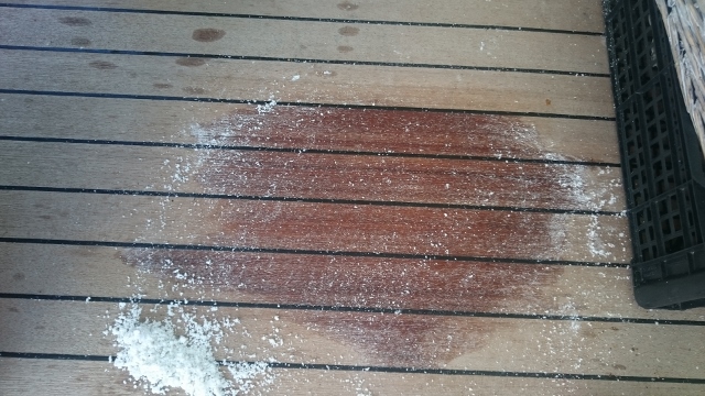

    Anyway I had few quest on yacht and they smashed a bottle of olive oil on teck and some kind hiden it :/ If I knew it happened i will clean it straight away and now I have this kind of problem

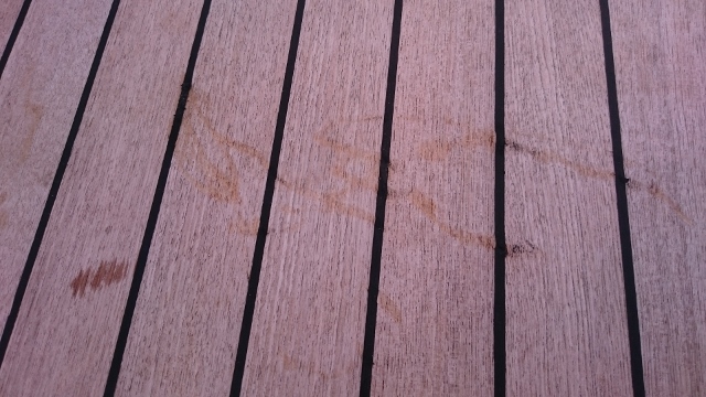

    Also few days ago I was in New Port of Chiavari ( trully I DO NOT recommend) and was very strong wind and vawes ( inside MARINA !! even eployers told me that theres is construction problem and when is sh*t weather than you need to be awake all night) and mine tender released its safety and hit teck few times as well. Is there any chance that I can cover it some way ?
  17. K1W1
    7,427
    If it is real teak you can probably sand some of it out, it will all fade to the same colour in time fresh dents can sometimes be fixed by soaking them with water and applying heat via an iron to steam them out.

    It will eventually fade but a spary called K2R is very good at removing a lot of things like that.

    For the oil, the best I can think of is teak cleaner, and then teak oil the deck. It should dilute and blend the other oil in. For the rub, as K1W1 suggests sand it lightly, preferably with brass wool.

    To clean oil off of teak use K2R.
    To clean the rust on the stainless steel use http://spotlessstainless.com
