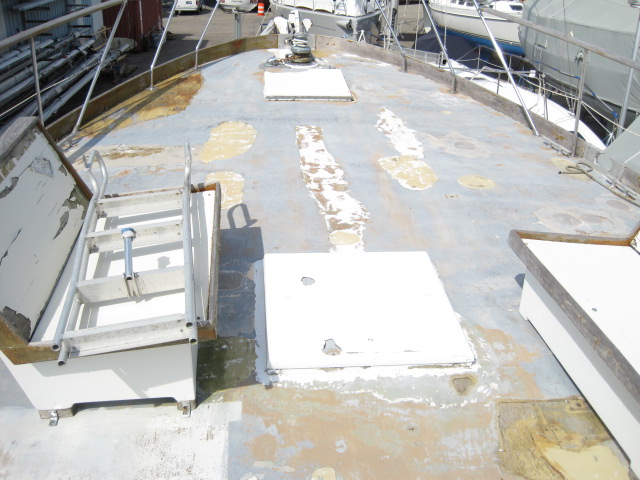

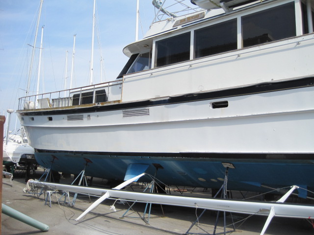

    74ft Roamer
    Guys,
    Here are some photos. I have a suveyor on her now. I will not see her until the 7th then we will do a more complete evaluation. She has been "rid hard-n-put away wet" A project but if the hull and mechanicals are good probably worth the effort. Does anyone know if there are any of the limited number of true 73/74 footers out there? I think there were only 4 or five hull ever made.

    Matowakan1, this is the 74 footer on Yacht World for $95k, isn't it?
    One problem I know about on the wooden deck Roamers is that the seam compound eventually lets loose. Then water gets into the deck underlayment and rots it out. Water also gets between the plywood and the deck supports that run around the perimeter of the deck, and both the wood and the aluminum rot. A buddy's 58 footer actually had holes through the deck support from that problem.
    It appears as if this boat had the same problem, but the fiberglass deck they installed doesn't look like it was well done. Redoing it could be a massive undertaking, especially if water has gotten into the deck and underlayment. Several of the interior shots show water damage--I'm guessing the deck has been leaking for some time. There could be lots of rot to deal with.
    But the hull, engines, and mechanical systems look good in the pix.
