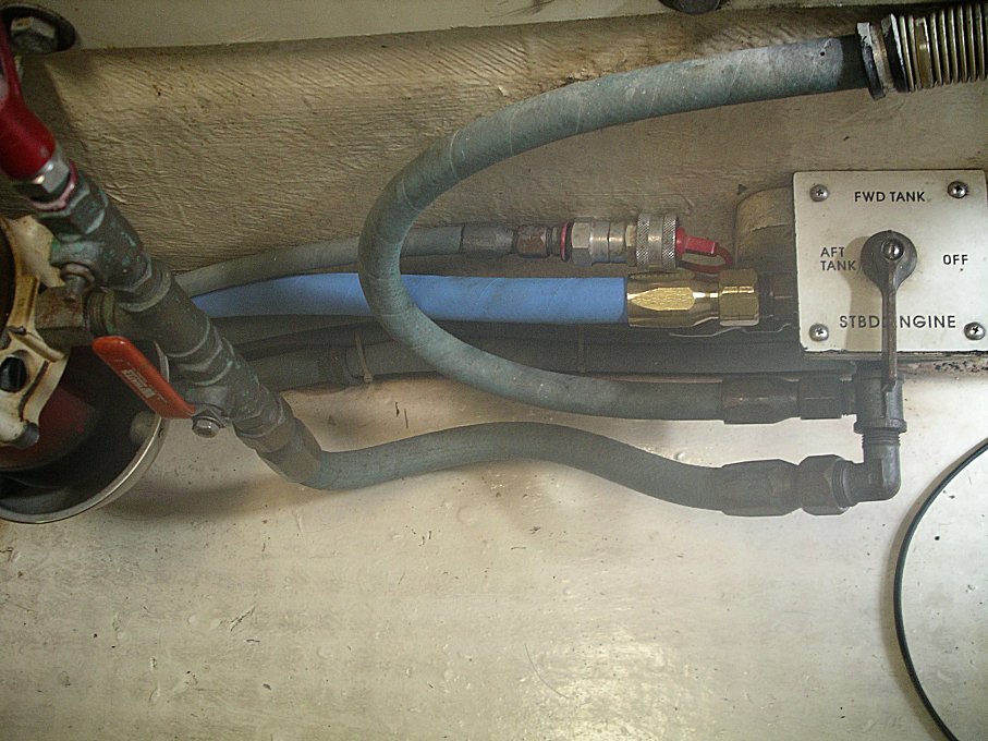

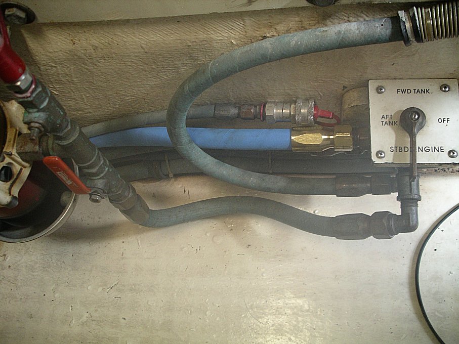

    Sounds like first your list and then the clean up. Welcome to boating. LOL Yesterday a new to me mechanic replaced a short length of starboard engine fuel line that had been preventing it from running off the forward tank. Previously one passed on the job and another left after attempting it. Decided while I have the right guy; to have him replace ALL the lines.
