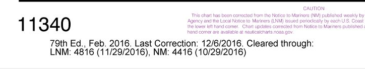

    The NOAA charts are updated weekly. The update information is published every week via the Local Notice to Mariners.
    The NOAA ENC charts are updated to reflect the information disseminated via the LNM's. I am not sure how frequently the Raster charts are updated, but the file they provide will have a notation in the lower left hand corner that will let you know how up to date that Raster chart is.
    Now, consider this: While you "think" the paid charts are updated more frequently. where do you think they are getting the data from to do the updates. If you guessed that the chart data for the paid charts comes from the Government Hydrographic Agencies, you would be correct. So the answer is, that the paid charts are NOT updated as frequently as the charts you can get for free for yourself from, in this case, NOAA.
