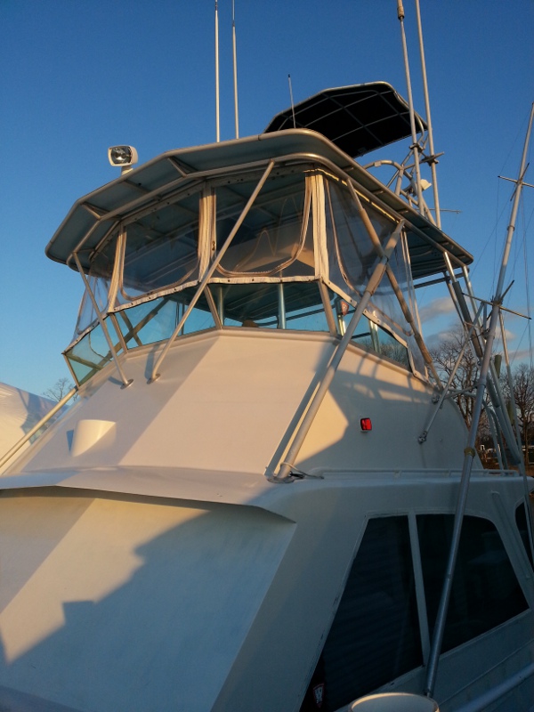

    I have a 44' Striker Sportfish. My canvas/plastic enclosures need to be replaced. I'm thinking of changing out the forward facing panels to regular windows. Right now the boat has a low windscreen with plastic enclosures going to the hardtop. I'd remove the low windscreen completely. The only thing it seems to do is put a horizontal bar right in your line of sight to watch for crab pots on the water. The new windshields would be about 45" in height 30" wide. Bridge is aluminum and hardtop is aluminum so not hard to mount. I'm tired of looking through the "clear" plastic on a rainy day. I could put windshield wipers on real windows.
    From what I've been told having actual glass in there wouldn't cost more than Ez2Cy or similar. Any recommendations on window manufacturers? Any negatives please PM me if you feel you can't post it publicly.
    What do you think? Crazy or good idea?

    Its about 30 sq feet. Probably an additional 120 lbs or so in 1/4" tempered/laminated glass. I'm planning on scaling back the 8D battery that's up there so really shouldn't change too much in weight. I'm somewhat worried about the looks but I was considering EC2CY or similar panels in the same configuration so I guess the style factor would be about the same.
    I'm not worried about shattering or breaking the glass from water pressure. If I ever got caught out in seas like that (40'?) I'm pretty sure the canvas enclosure wouldn't survive it either.

    You've got 3 flat panels on the bridge topped by 3 flat panels on the glass frame How do you plan to eliminate the bars between panels no matter what you use unless you build a new curved frame on top of your glass. EZ2CY could eliminate the canvas around the roll ups, but I think you're stuck with two frames of some type no matter what you do. I wouldn't go with glass as you'll probably roast in there on hot days without any air flow. With EZ2CY you'll be able to open the P & S front panels or the middle one, but I can't see any way to open all three as it doesn't bend.
    One big plus to the isinglass you're currently using is that you can open it a few inches to allow airflow on hot rainy days. Sometimes it's better to go for functionality rather than esthetics.

    Good points. The lower glass will all be removed. The vertical bars would stay. No horizontals. There are no curves to worry about. Top and bottom mounting rails will be parallel. I'd leave the center panel fixed. The sides could either have top vents (12" or so) , upper 12" vertical slider or the entire window would hinge at the top and open out at the bottom. This would be similar to the windshields on many boats with lower helms. Actually the same design as my boat originally had for the salon. Even opening them 6" would funnel a tremendous amount of air to the bridge. The sides would remain isinglass.
    I may end up taking everything off and mocking up the frames to see what it will look like and how it will work.
    You are right about the EZ2CY. There is not enough room to open the EZ2CY panels all the way unless you hinged them on the side and then it would be all or nothing.
