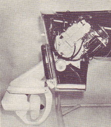

    We have had a similar drive in Sweden, where you didn´t have to build a special transom. The prop was forward facing and it had a two-speed gearbox. I think they produced 2000 of the Crescent Drive 45°, in the mid 60:s...
