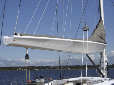

    But for really easy tradewind sailing, You will need a rig, capable of carrying tradewind sails. And definately go for a trampoline boat. A sloop rig with multiple furling forestays, a park avenue boom and full button main sail will for sure do the job.

    park avenue boom, where You just can drop the full button square head mainsail into. Much easier to handle, especially with kids on deck.
