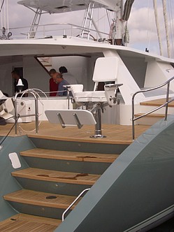

    Here's a cat fitted with a chair for your needs
    I got this from Yapluka yachts that builds custom cats out of Caen France.
    This was fitted to a 75' sail cat called "Wonderful". 6.7mil US
