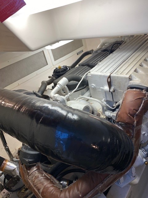

    Trying to decide when to remove the aftercoolers on the C12 CATs for cleaning/pressure testing and or possible replacement of the core as recommended by CAT to at 6 years. The engines have ~1,200 hrs.
    I have seen discussion on boatdiesel.com as well and wanted to reach out on this form for any feedback and or recommendations.
