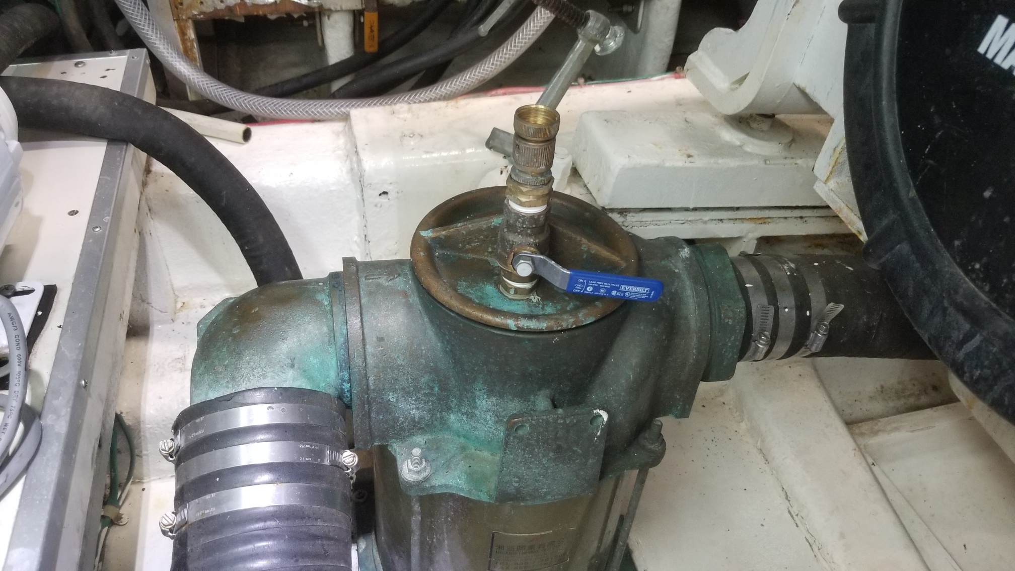

    I went with a slightly different approach with my 3412Es (possibly stolen from @mapism, not sure). I drilled and tapped the thick bronze covers of the sea strainers and run fresh water directly into those, closing the intake seacocks (one engine at a time). Dock water pressure seems to be able to keep up with the raw water impellers with the engines idling. Works fine and just takes a few minutes if the boat is going to be idle for more than a couple days.
