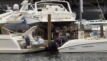

    White Lightening that was owned by Ben Novack has been sitting in Apex Marine's yard in Fort Lauderdale for months and months with not much activity. Reportedly she was one of his most prized possessions. In the last several weeks all 4 out drives have been removed and patch work has been done on the hull. Is this the boat you are talking about?

    Looks like surface drives in the picture

    Yes, I took that picture on 3/6/11. Yesterday when I was walking along the Riverwalk I noticed the drives were gone. I'll take some more pics next weekend when I am down that way again.
