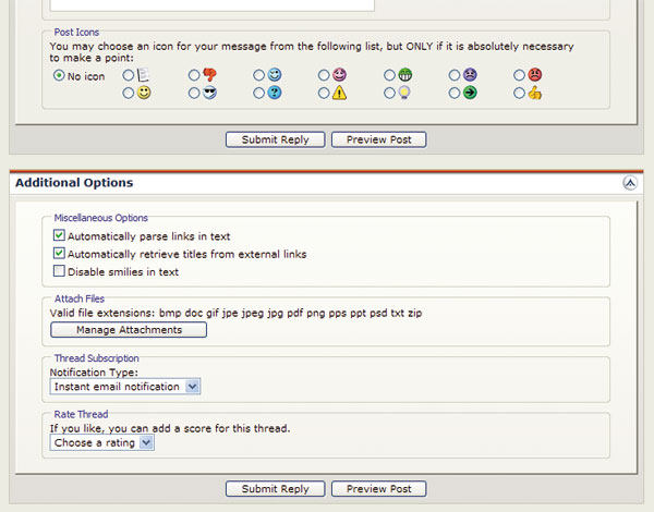

  18. AlfredZ
    AlfredZ Senior Member
    Oct 29, 2009
    561
    Landlocked in Europe
    Attaching images.
    Click on "Post Reply" button.
    Scroll down to "Aditional Options".
    Click on "Manage Attachements".
    Browse to the desired image and couple of clicks later you are done!
    The forum has a rule that image width should not acceed 600 pixels so abide by that and above all, the image should be owned by you or you are authorised to use it otherwise it will be deleted under copyright terms.
    Cheers
    Alfred
