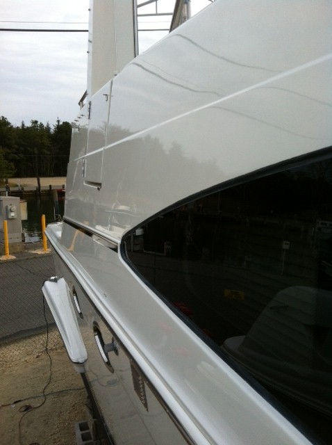

    I had to chime in here because I think a lot of it depends on the person using the buffer and the products being used. My Carver stays like this for the season. Below the rub rail I don't have to do anything but above the rub rail you have to wax every 6-8 weeks. I wash weekly with Imar yacht soap to not strip wax. I see most marinas using heavy compound and then simply waxing over it. That leaves the gelcoat very porous allowing the sun's rays to penetrate the gelcoat more and it oxidizes quicker, resulting in it not lasting long. Wax is for protection, not shine..

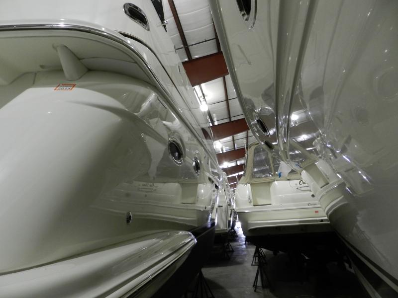

    There is a difference between Carver gel coat and my buddy’s Sea Ray. I have been told that the formula is different but I am not a chemist so I will leave that to those that are in the know. What I can tell you is that I have not seen the muddiness that has been alluded to in this string. With proper care most gel coats will shine beautifully. Here is an example of my Carver on the left reflecting the stern image of my friends Sea Ray. His was done professionally and mine was done semi professionally (me). Understandably the greater the angle of the shot the more shine you see but during straight on viewing we shine about the same. (I had a better example but the picture was too large to upload.)
    Dan

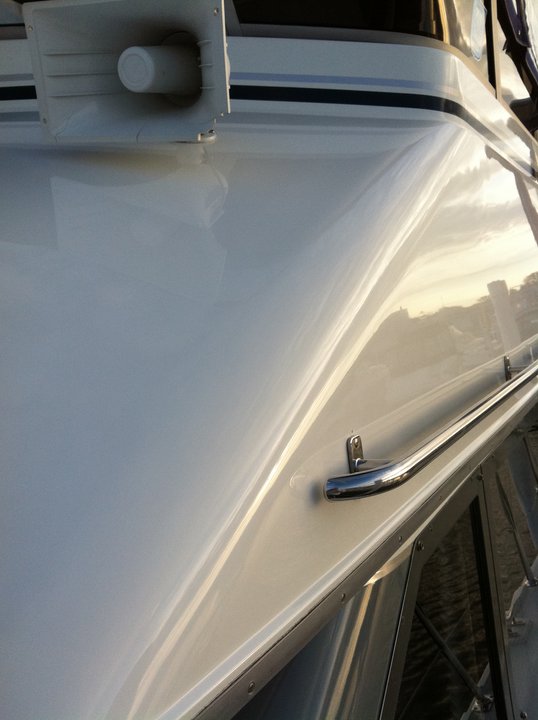

    My 18 year old Carver gelcoat looks wonderful. Buffed with Buff Magic and protected with Rejex.
