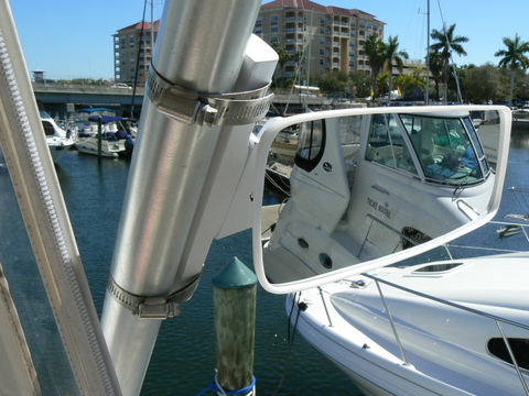

    My 98 355 has two dome lights that I replaced with LED's. I'm installing a solar landscaping light to illuminate the swim platform, I'll post a pic when I'm done. I just installed a mirror on the helm, better IMO than a camera.

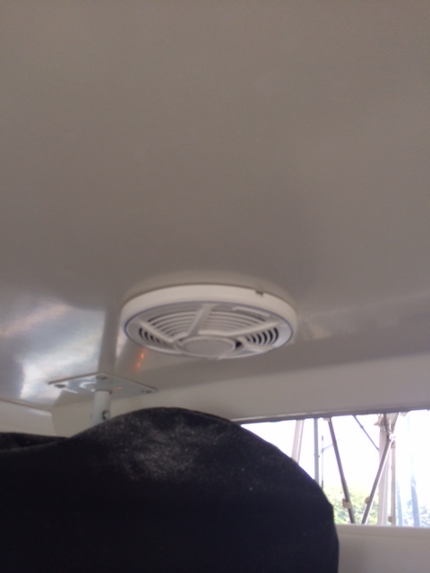

    i have a 97 405 very similair to your 355.last year i added led floods to the aft outer corners of the hardtop facing behind the boat and somewhat toward the swim platform and was able to fish wires through the hard top. i removed the existing led overhead recessed lights to help gain some access and also my boat had stereo speakers installed in the hard top so i removed those also. fishing it took a little work but it is doable. i also left a pull string in case i want to add something else later, afterwards installed the speakers and recessed lights back in their places. i dont have pics of the work but i hope this helps. although i have pics of the finished project

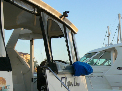

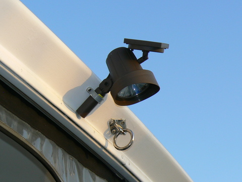

    My answer to illuminating the swim platform and a rear view camera.
    The solar LED is cheap and will illuminate the swim platform when I return to the boat via dinghy after dark and I don't have to remember to turn it on or worry about it draining the house bank. Swiveling it left and right will illuminate the grill, no more remembering to bring a flashlight along.
    I've used the boat a couple of times with the mirror and it works well. I was worried the image would be too small but that doesn't seem to be a problem.

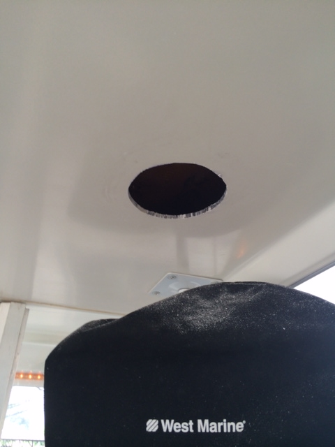

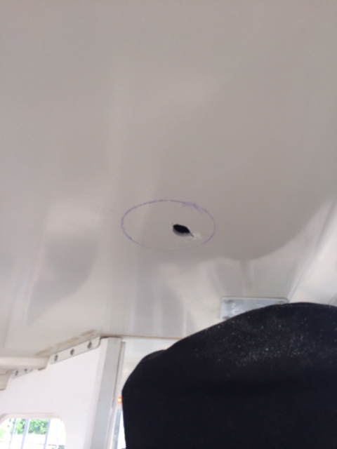

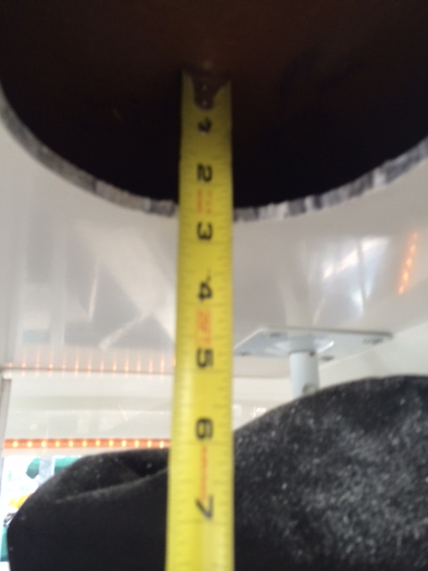

    So I get up the nerve and start my project:
    First cut the pilot hole to make sure I am not cutting through any wire, once done I then cut the full speaker hole. To my dismay, as you can see from the video, no hole exists between the arch and the hardtop. The wire for the in-hardtop lighting is wired thru the aft cabin and up through the port aft hardtop support leg. :( .
    I plan on drilling a hole in an inconspicuous area on the top of the hardtop and the arch and running the wires through them. Lesson learned. I attached the photos and video for those 355 owners who always wondered what was up there :)
