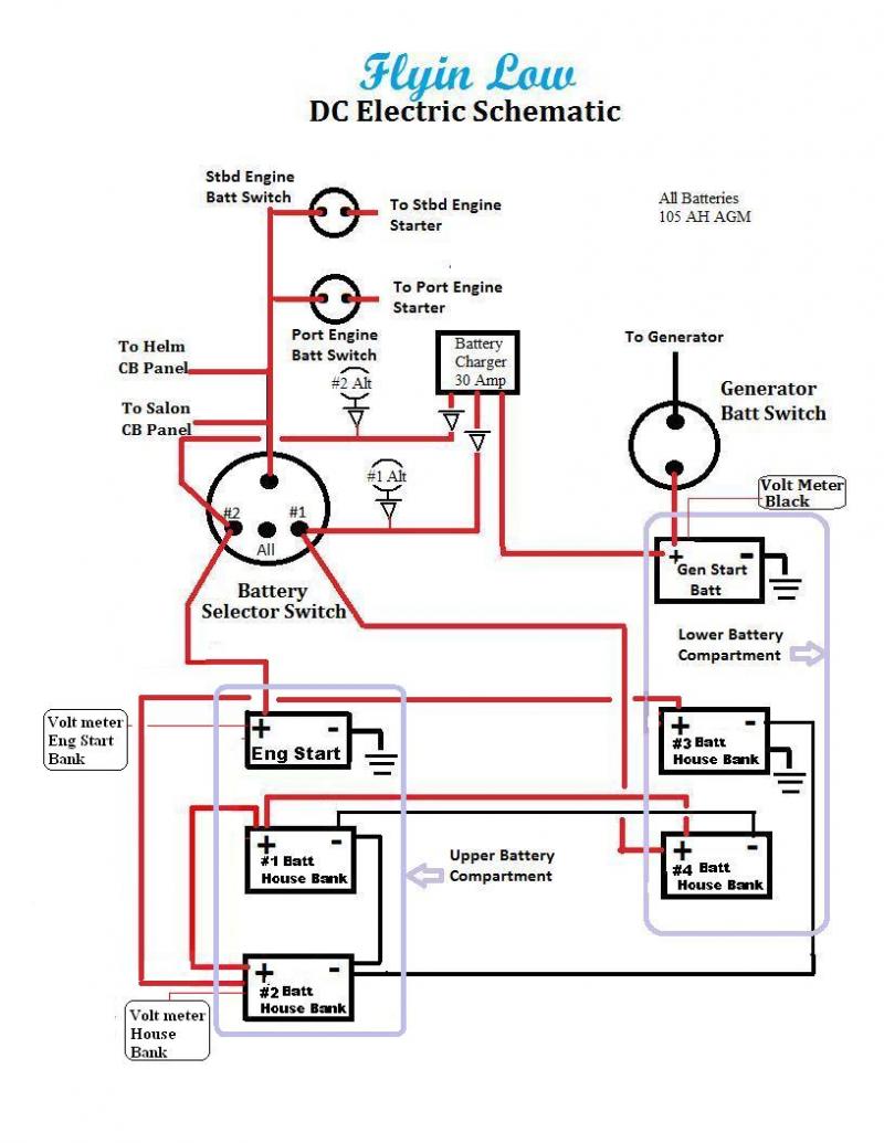

    Before adding batteries and charging capacity you must determine your electrical usage. Your primary user is probably your refrig. Remember your battery capacity must be twice your usage so as not to deplete your batteries below 50%. Lastly, figure a battery charger will replace about 75% of it's rated capacity before it goes to a float charge. That's a rough number but you should get the idea. If not the point that I'm making is the charge capacity must be greater than the usage. Don't think that a 100 amp charger will replace 100 amps in an hour. Or an alternator for that matter.
    I have 3 battery banks on my 35 Carver.
    #1: One 95 AH gen start battery
    #2: One 105 AH engine start battery
    #3: 4 105 AH House batteries.
    The gen and engine start batteries don't need to have much capacity as they are hardly used, generally once a day when cruising.
    My house banks has 420 AH but only 210 is usable because you don't want to deplete more than half the battery capacity.
    I estimate my electrical usage at 300 amps per day when on the hook, primarily due to an older norcold refrig. So I recharge twice a day once in the morning and once in the evening. My 30 amp 3 bank charger is useless when on the hook (I would have to run the genset 10 hrs per day to replace those 300 amps) so I must recharge using the engine alternators which are 100 amp each. Running the engines at 1000 rpm for an hour twice a day pretty much does it. But if I'm on the hook for several days I would need to run the engines twice that.
    A battery schematic is attached.
