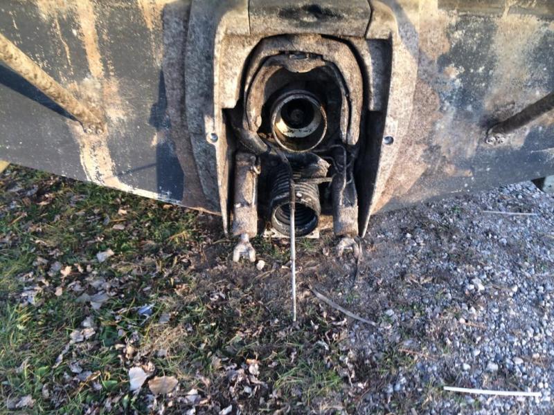

    There were 3 to 4 drives during that year. If you can post a picture of the transom shield we can respond better.
    AQ270b, 280, 280 with trim with or with out dp, 290 with or with out dp.
    Late 80s was before Volvo and OMC started working with each other so it would be one of the original AQ systems.
    Red was the original Volvo/Chevy color. I would think the 260hp/350cid would have been more original. 454cid may have a bit much for a factory 270 but could have a life. Don't think there was a Y exhaust collector for LB & 270. Volvo used a souped up 350cid option that made high rpm and near 300hp on the 280 and early 290s. Factory 454cid's were usually on the 290 & 290DPs.
    Send some pictures in and one of the top of the transom shield from the inside.
    Were looking for tilt mechanism, trim equip, and drive helmet folded down.
    Of course, if the factory tag is still in place would make this real easy. Inside, upper stb on the transom shield.

    1988 Carver 27 Out Drive

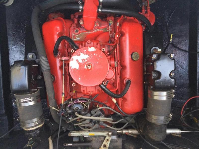

    You folks are great and thank you for lending a hand to a newbie. I attached the photos of the transom
  5. Capt Ralph
    13,389
    Yep, That is the AQ290 transom shield.
    Modified exhaust Y collector.
    Chev MK-III, 454cid raw water cooled.
    Holley carb. electric choke. vacuum secondaries.
    Mounted on a Q-jet intake manifold with a Holly to GM adapter plate.
    Merc styled exhaust manifolds.
    Prestolite distributer and coil bracket off of a 350cid engine. Still works but you can see the throttle
    cable lock does not fit. Probably one bolt holding the bracket in place.
    Looks like some remaining factory power steering parts in place but a Sea Star styled hydraulic cylinder
    installed.
    Raw water thermostat housing also from a 350cid.
    Probably the original Johnson raw water pump mounted to the crank pulley center from the 350cid.
    This may be undersized.
    Prestolite alternator.
    Original Volvo/AC styled mechanical fuel pump may have come from the 350cid also. It should work.
  6. Capt Ralph
    13,389
    On your x-mas list, look for a AQ290 DP drive. V-8 Gas gear ratio.
    B-4 prop set.
    Maybe a new carrier bearing
    New bellows,
    New water hose
    New trim hoses (not in pic but way in there between the trim cylinders are two black rubber lines. Pain to replace but trust me, you want them replaced now.
    Shift cable log (rubber hose on the inside of shield that shift cable runs thru
    All new clamps.
    Check the shift cable real good.
    Bucket full of mounting pins, bolts & washers.

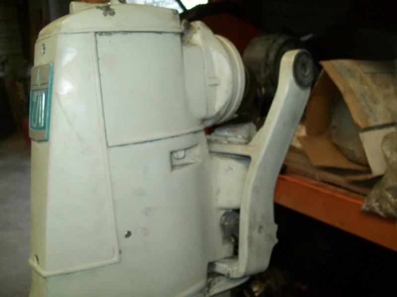

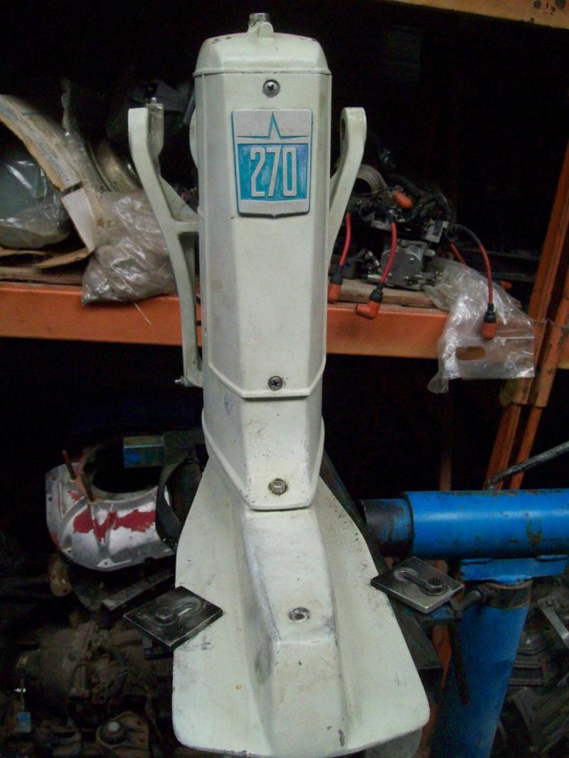

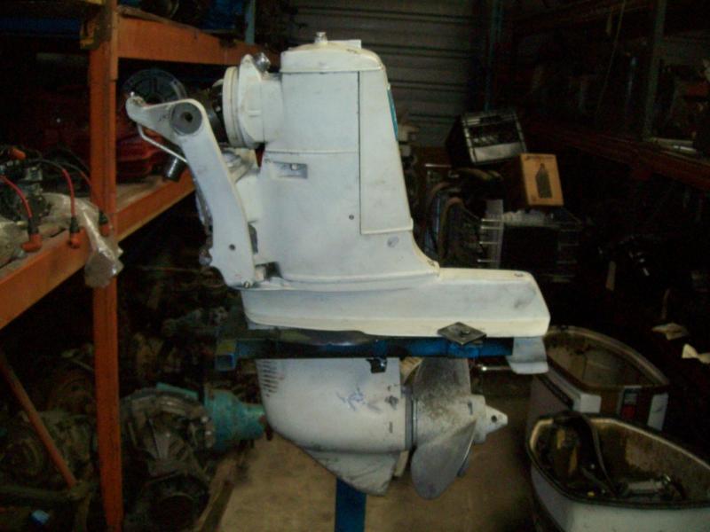

    Getting Closer
    Volvo Penta AQ270 sterndrive/outdrive: PZNR 27101509 D
    Is this the beauty to take home from the dance?

  9. Capt Ralph
    13,389
    NO, Need AQ290 or AQ290DP.
    DP = Duo Prop. Will cost more but you can back the boat. With out the DP, you just back in circles like a single inboard.
