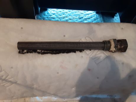

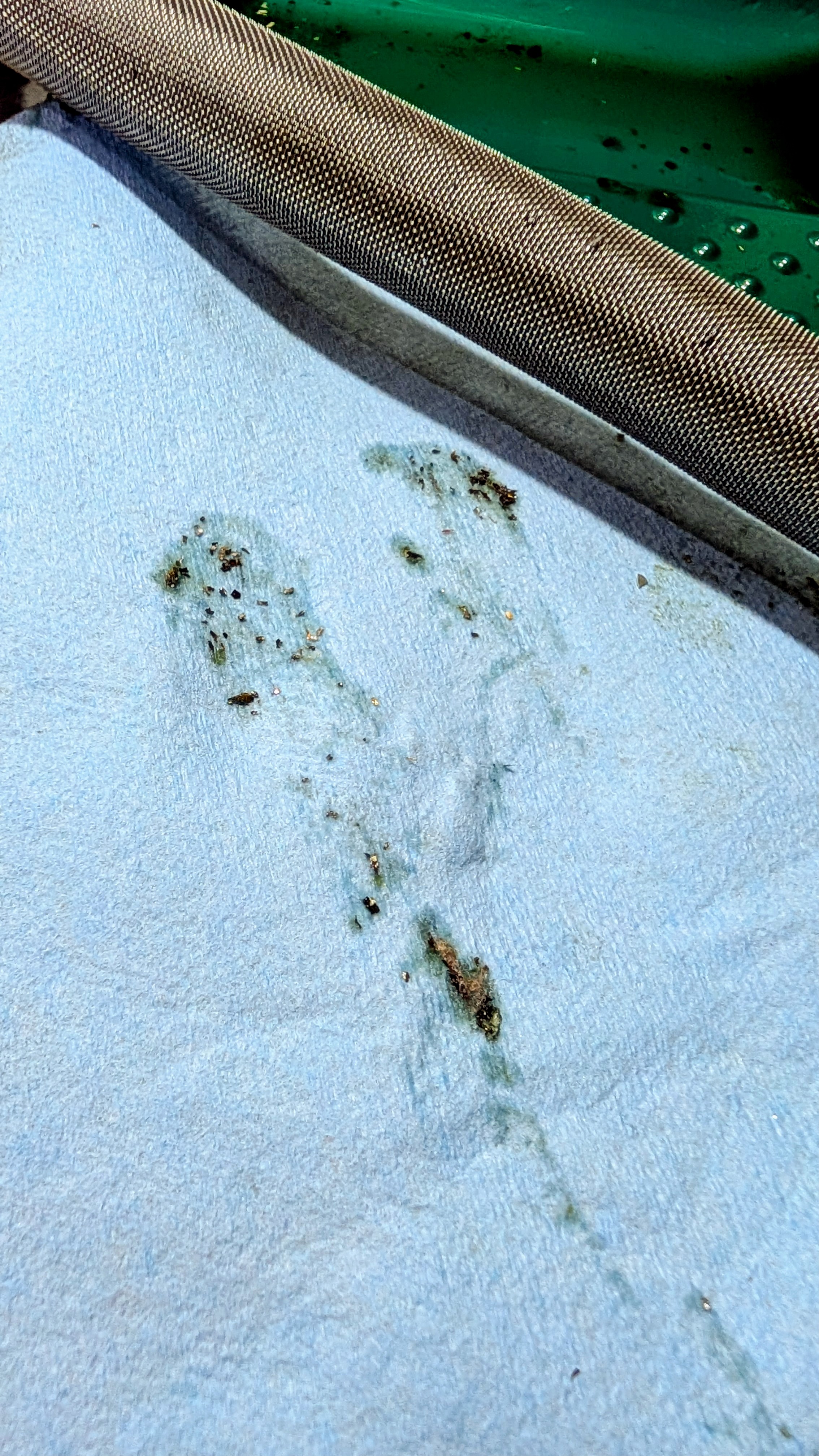

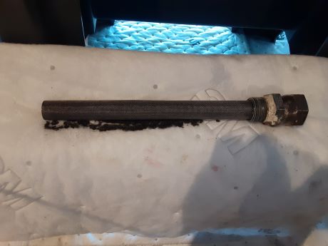

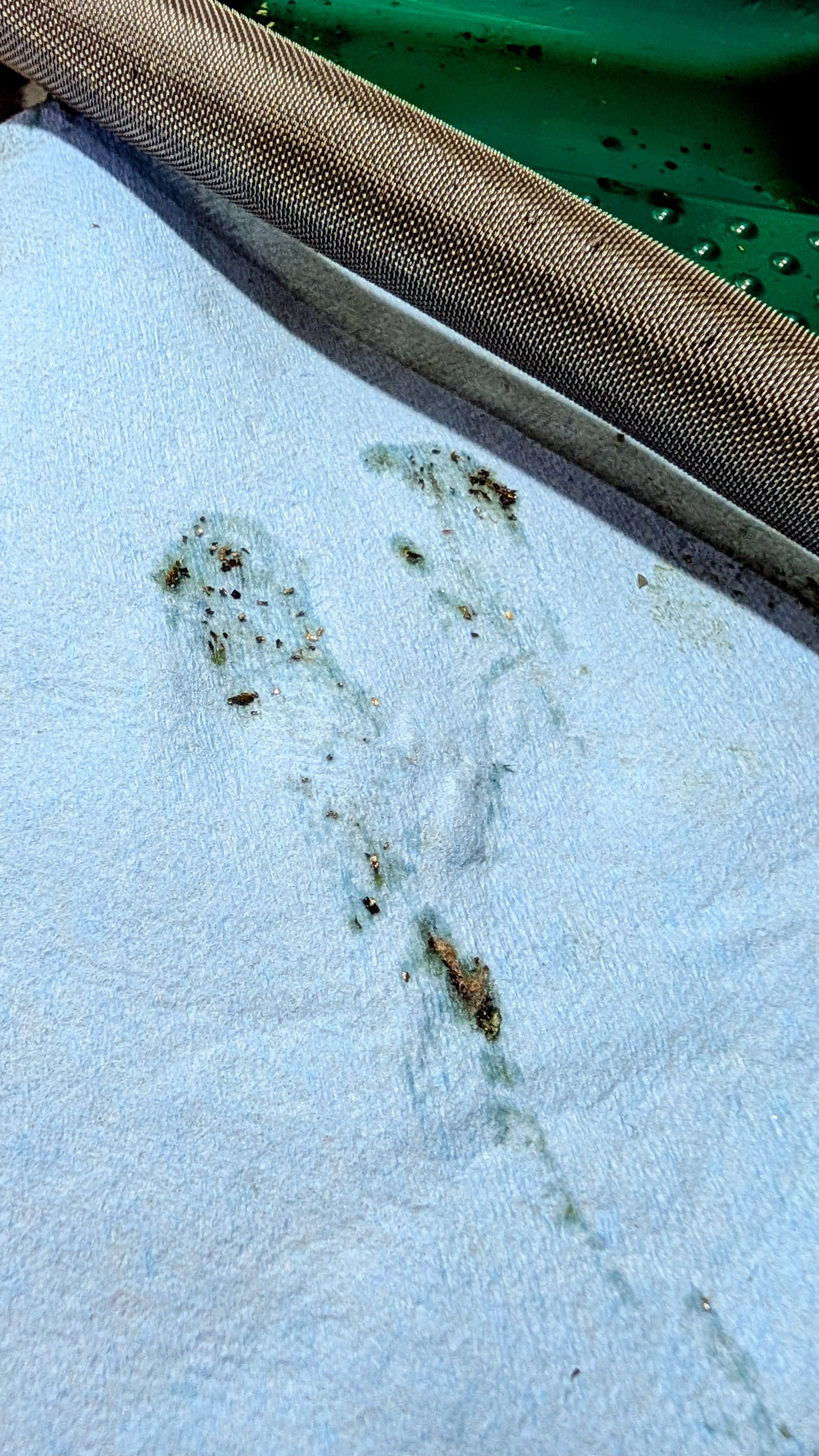

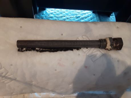

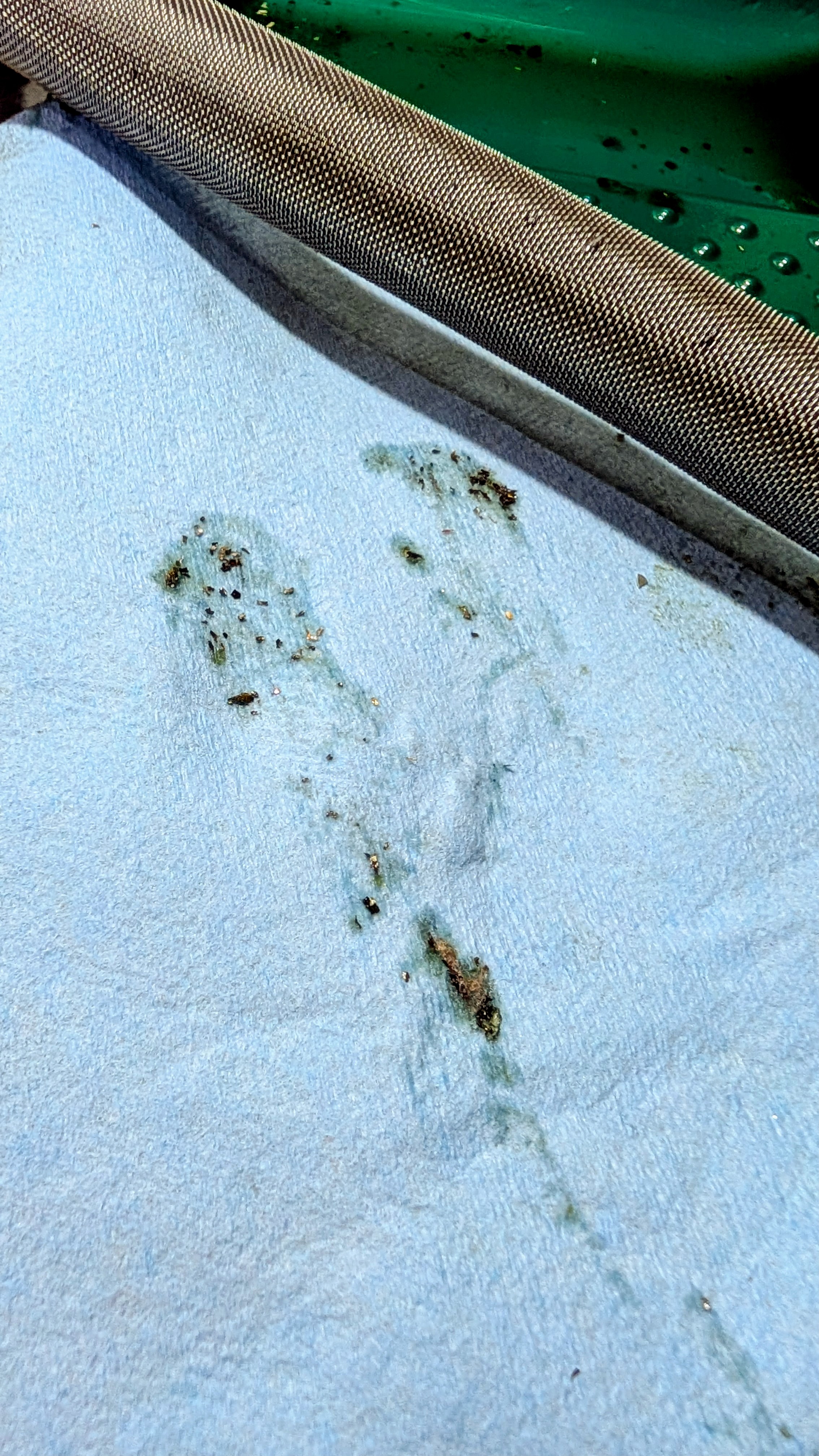

  7. Brian Beal
    Brian Beal New Member
    Dec 30, 2017
    3
    Hinckley, OH
    Got it out on Sunday. Some black, kind of slimy stuff and a few small shiny flakes. I have no idea when, if ever, the oil was changed. About 1400 hours on it.
