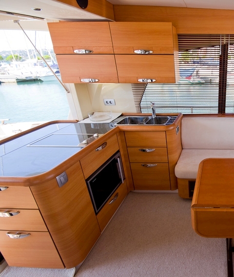

    I've been led to believe that the 'inductive cooktop' is that much better then the conventional electric cooktop? The heat gets transferred to the pot and food much quicker, and expends less electrical energy doing it. Plus there is no chance of getting accidently burned by the inductive cooktops, nor leaving them 'on' by accident??
    Oops, is that an inductive cooktop you pictured there?

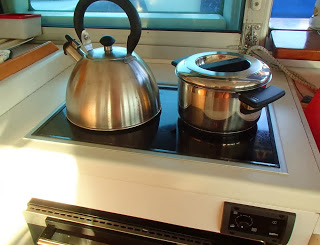

    We've lots of experience with both induction (at home) and microwave convection on the boat. Our new house has a fancy gas cooktop. We much prefer the induction top in our previous house because it is faster, more controllable and no excess heat to overpower our AC if you live in a warm climate.
    I'm trying to locate a nice drop in induction for the boat to replace the Princess electric cooktop. We do have a "portable" induction top for the boat already.
    Induction pots and pans are nothing special, they need to be magnetic and can be purchased at IKEA if you don't already have some.

    I did not say inductive cooktops are fancy by any means. I just said, you have to be aware that the bottom of your pot and pan has to be magnetic. Especially on a small galley, the inductive cooktop is very handy, because you can use the cooktop seconds later for placing items (except magnetic ones :)). The galley layout and equipment is a totally different story on a liveaboard or a longe range trawler. Here, you want household type hardware and more space for cooking and baking plus trash compactor and a large fullsize freezer / fridge like on this circumnavigator.
