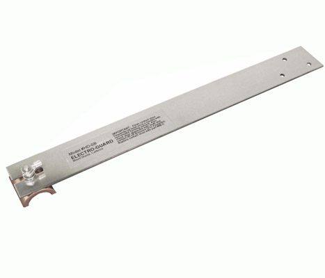

    I will be installing the Electro Guard shaft brushes, see photo, sometime this week. The struts and bonded as well to the transom zinc via the strut flange fasteners. Based on the above from Capt J, I will be sticking with the transom zinc only. Last time I was in the water, I put a mask on and inspected all the running gear. I did not see any visible burn on the blade tips on either prop. My Cabo currently has the Pro-mariner brushes installed, however the port shaft brush has fallen off which prompted the purchase of the Electro Guard shaft brush/scraper as a replacement option.
