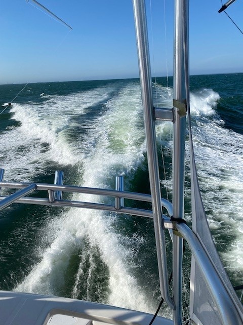

    I had some guests out on my Cabo 40 during the 4th of July holiday and a couple of folks thought the engines were loud. To me there is nothing better than sitting at the helm on the bridge and listening to the C12s at cruise. I have to admit it is a bit louder on the bridge when compared to my previous boats.
    Any recommendations to reduce engine noise on the bridge of a Cabo 40?
