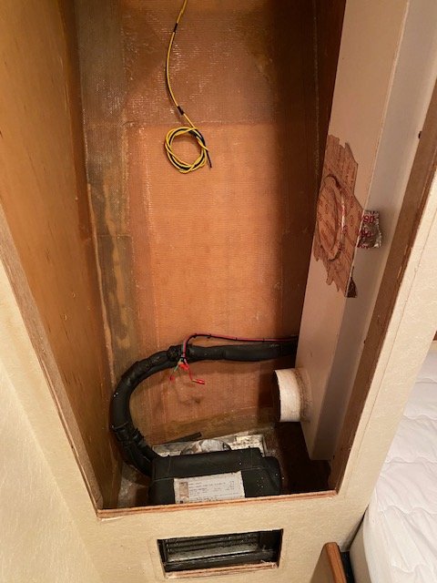

    The fan motor in the guest bunk room on my Cabo 40 started to squeal today. Sounds like a bearing issue in the motor maybe. Has anyone had a similar issue and if so how do you gain access to the air handler fan motor?

    It's been a long time but I believe it is under the bunk near the a/c unit.

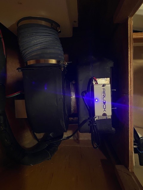

    The air handler is below the stbd hanging locker in the guest bunk room. The locker is easily removed which then provides easy access to the air handler. Bearings in the fan motor are failing.

    I removed the door and then the wood screws on either side of the frame and the whole hanging locker slides out. Good access. Now to find a new motor to fit the air handler fan.
