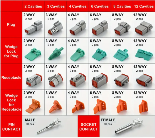

    The plug is a deutsch style with the terminals enclosed - is there a good way to test their fit?

    They're definitely some of the best connectors available , but I have had some that weren't engaged with the lock tab. You can see pretty much with a glance if a pin or socket isn't at the same levels as the others, and just a nudge with a toothpick or pencil eraser will show if there's a loose one. The silicone weatherseal can hold it in near-position. If it's the type of Deutsch with a locking wedge, it can be pulled out to push the terminal into the locked home position if you encounter one.
