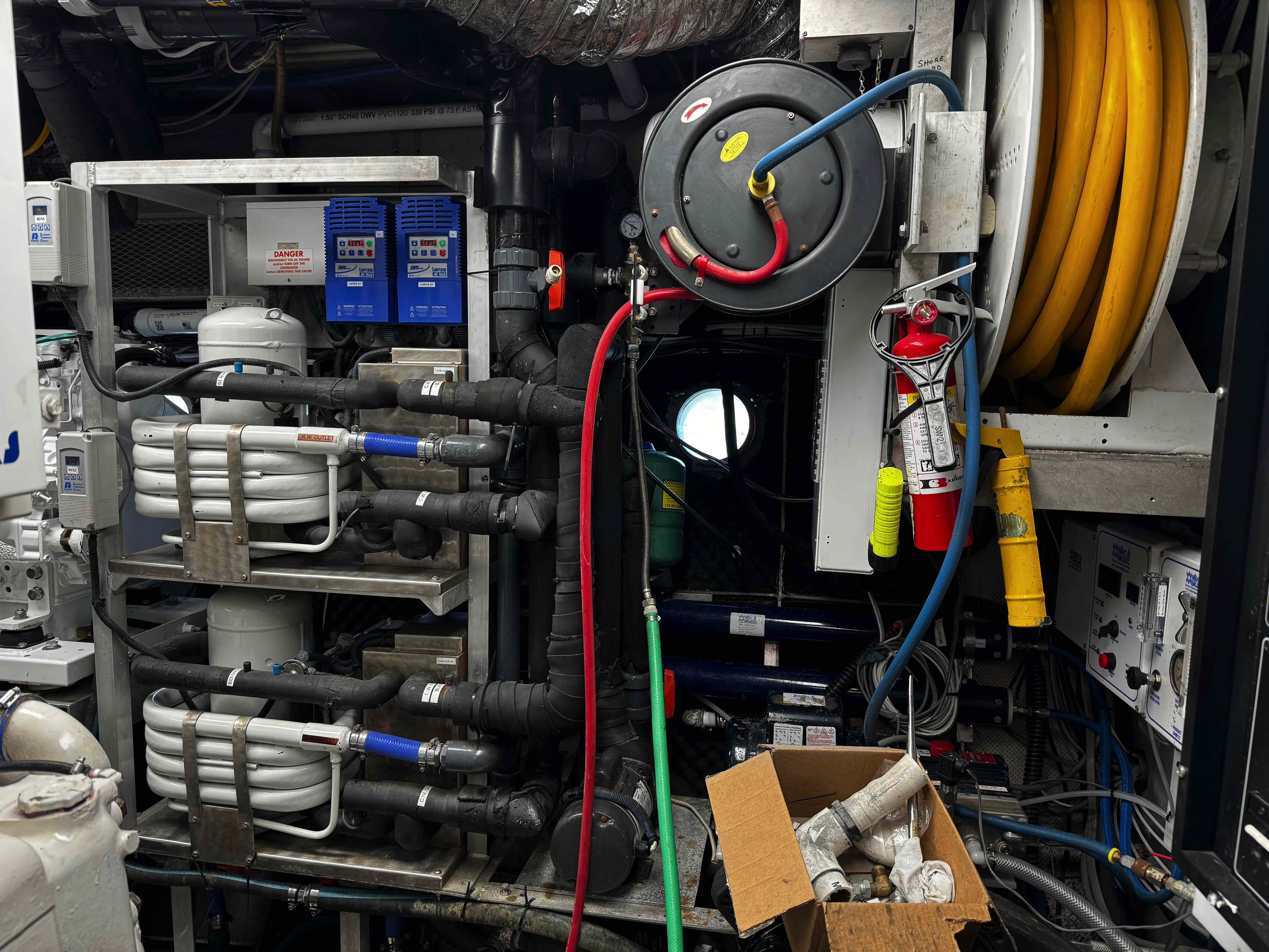

  11. rtrafford
    rtrafford Senior Member
    Jul 13, 2019
    1,703
    Vero Beach
    My ER setup...
  12. Capt Ralph
    13,270
    Sweet
