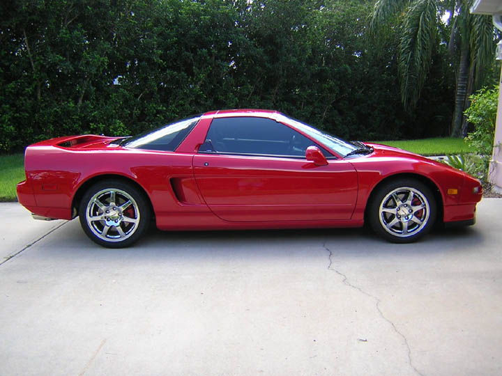

    +1 on Zaino. I was turned on to this product by the previous owner of my NSX. The paint on the car had a luster and depth unlike any I had seen before. It had several coats of Zaino. Show car guys swear by this stuff. It's super easy to apply and remove, leaving no wax residue. Best of all, it still beads after a couple of washes. It's a bit more expensive than some store-shelf waxes, so I haven't used it on something as large as a boat.
