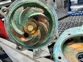

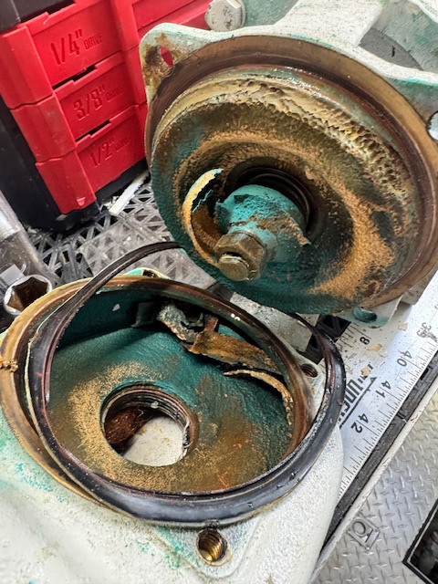

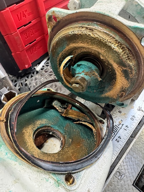

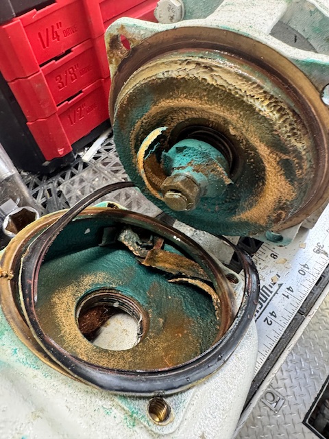

    Why I don’t like Scott and Cruisair air con pumps with bronze heads and impellers:
    after a few years the impeller and the head erodes and flow drops. We have two pumps on the 110 I run, with only one running at a time. Couple of days ago I switched to this pump and noticed my coils were running a little hotter. Decided to replace it this morning with a spare rebuilt we had on board. Bette reflow, chillers running 10 degrees cooler and sure enough the impeller is eroded. It had a label on it indicating it was about 5 years old
