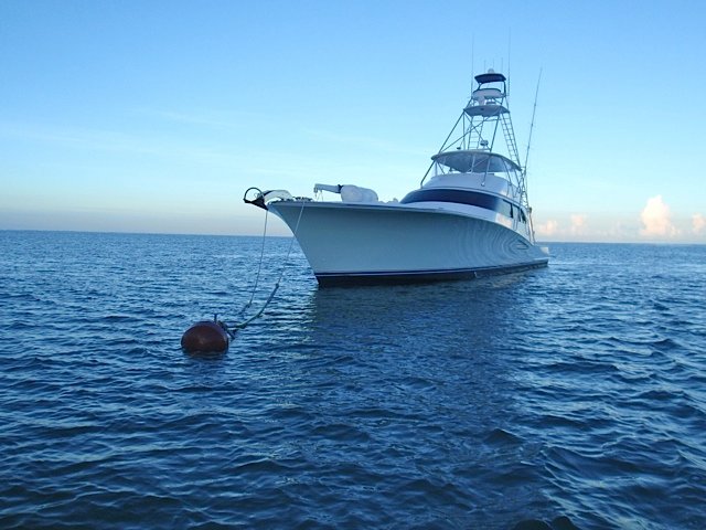

    Here's a picture of the bow of a Custom Sportfish, where bow fitting with anchor, I suppose may be retrieved.
    The pictures of Wally posted, show the system.
    Now the question is:
    Are they made as close system or should the parts be purchased from different Manufacturers and then assembled together?:eek:

  8. Capt Bill11
    Capt Bill11 Senior Member
    Feb 27, 2006
    1,459
    Sarasota/Ft. Lauderdale FL
    They have ready made anchor roller systems similar to that one. But that one looks custom made or at least perhaps custom made by that builder to me.
    If you know what brand that boat is and that is just what you are looking for try contacting them about it.
    UMT makes custom rollers.

  12. Capt Bill11
    Feb 27, 2006
    1,459
    That's kind of cool in theory. But in an emergency or if the system fails you're kind of screwed. Also note the wire tie or what ever it is holding the shank of the anchor in place. I wonder what's up with that?
  13. AlfredZ
    AlfredZ Senior Member
    Oct 29, 2009
    561
    Landlocked in Europe
    In an emergency, you won't need to fold the roller back, just pull the anchor up and secure those two pins you are asking about and you are ready to go, those pins unite the anchor and the roller. Many sailboats have those self-stowing anchor systems. For me, these things waste locker space! Am kinda old fashioned and like the sight of anchor and chain!
    The emergency concern would be when setting the darn thing if the system fails and you have a heavy anchor! You will need good muscle power to pull and pivot the set out while watching what you are drifting towards or being pulled into!
    Just a last note, this system is independent of the standard windlass, it works before and after you are done setting or retreiving the anchor.
    Cheers,
  14. Capt Bill11
    Feb 27, 2006
    1,459
    OK I guess you are saying the thing can be manually pulled up and folded out over the bow?
  15. AlfredZ
    Oct 29, 2009
    561
    Yes, if the system is not engaged and if the operator has the power to do so!
