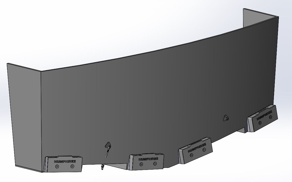

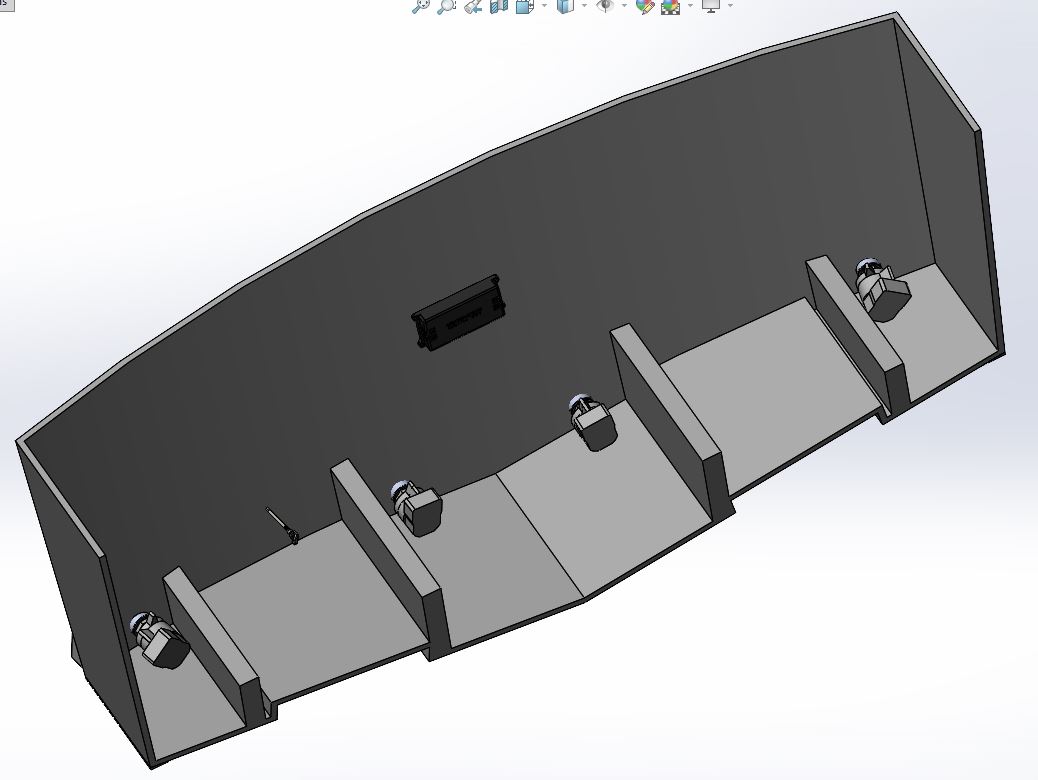

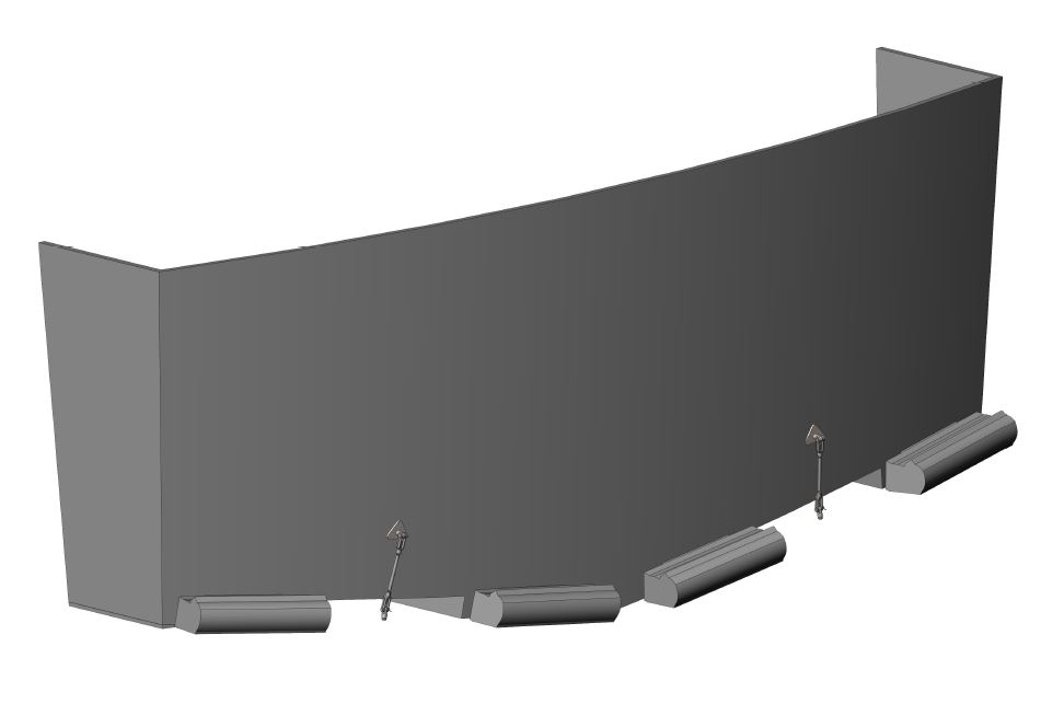

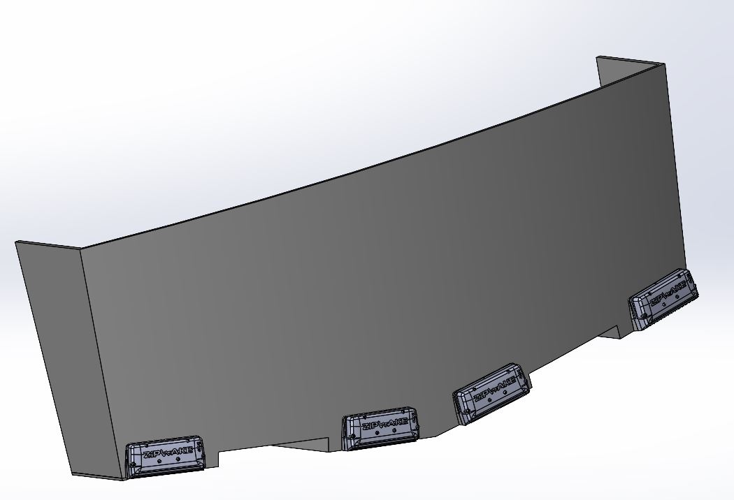

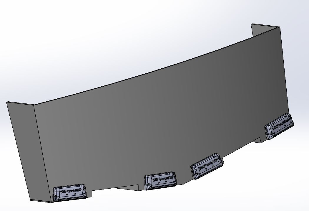

    Thanks. I've been using my CAD model to check planned internal component clearances. Around 1" is good.

    CAD model of your 43 huh? please share some screen shots please, did I say please? ;)

    It's only the transom, tab pockets and main stringers to look at clearances and curvatures for various interceptor options. I don't have the measurements or ambition to do the full hull.
    X-450 Installation - Stern.JPG X-450 Installation - Interior.JPG Zipwakes-E - Stern.JPG Ride 450 - Stern.JPG

    Interceptors on a Post, that's interesting. Winter project?

    Are you thinking to keep also traditional flaps?
    If yes, I think that the two interceptors outboard of the props might be enough.
    Also because they are the ones more effective for roll control anyway.

  9. Greg Page
    Greg Page Senior Member
    Mar 4, 2017
    501
    Annapolis MD
    Interested, roll bothers the cat (she rides on helm chart table). Started looking a year ago. Cost to remove tab pockets is prohibitive. I have a personal SolidWorks license so ... Made a model to see what might be physically possible. Clearance of actuator to bottom and main stringers (non-structural filler for tab pocket would require offset actuator to clear stringer to use the space), thru-bolt clearance (Zipwakes couldn't thru-bolt, interfere with stringer), spacers to accommadate flat actuators with curved/raked transom (fastener length/bending, CNC costs) etc.
