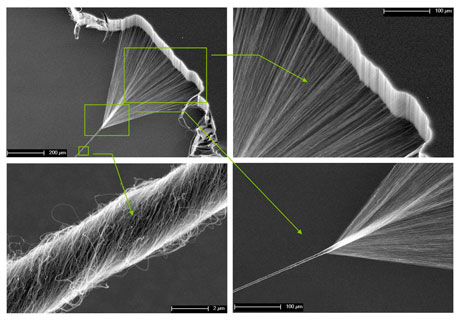

    Was curious how they made a fabric out of short (10-15u) tubes and found this neat picture showing how the short tubes are gathered and spun into a continuous fiber.

    Marmot, Nice pics. Looks like the strands are being pulled from the edge of a block of vertically oriented nano tubes. The question is why do they stick together? Are they fuzzy?
