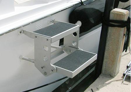

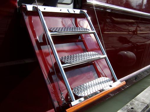

    If they don't care much about the looks, they can rig the seastairs with ropes to fold upwards, some boarding systems from other manufacturers come ready for this setup and offer flush side folding and articulating features. You see this on many of the larger sailing boats and older motor yachts. I have done it with on a 78'er with aluminum seastairs, did not look nice but worked fine and I think it still is working fine.
    Other options would be like the attached pictures. (I like the conversion of the gate itself. Neat!)
    The first is from a company in Boynton Beach, FL, and the other from Richmond, BC.

    Thanks so much for all of the helpful suggestions. The gate conversion is super and gets my vote. I also found out about Fender Steps.
    Really, much appreciated. I'll let you know what is decided in the end.
    Judy
  8. NYCAP123
    11,208
    With the gate conversion keep in mind they'll need it on both sides.
