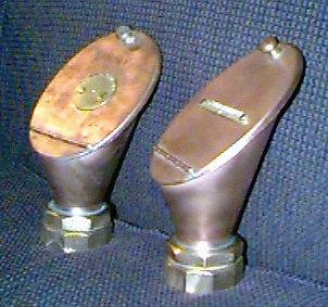

    the copper, brass, and bronze mouthpieces i've seen on open decks generally have hinged lids to prevent weather and critter infiltration. No idea where to get such a thing, but see below for an example.
