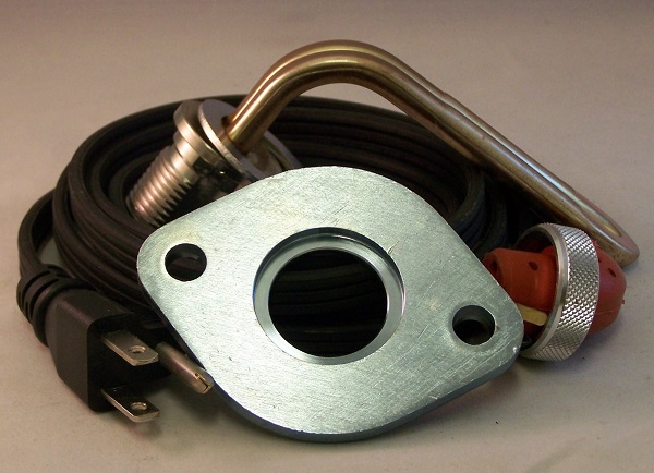

    I have a pair of 1985 J&T Detroit 671 TI's in my boat. I know how to remove and replace the block heaters. What I don't know is, how to empty the block prior to removing the block heater. My block heaters are located behind the fuel pump just above the stater motors.
    Can anyone give me some insight as to how to empty the block without the antifreeze going into the bilge?
    Thanks for your help.

    That would be ideal, however the block heaters are held in with two bolts and a gasket in between. Thanks for your quick response.

    Interesting.
    Then your install looks like this?
    Make sure it is really the element and not the power cord that is bad.
    Then on a cold engine;
    Do not open your heat exchanger cap.
    Have your new heater assembly ready.
    Remove your proven defective element assembly out. Stick a plug or rag in there.
    Clean up the gasket area well.
    Use grease on the new gasket.
    Reassemble. Do not over tighten the new bolts.
    You will not lose much coolant.
    Pour us a beer.

    Yes. Thank you for your input. That's the block heater mounting plate used on my 671. Seeing as the current block heaters were installed back in 2009, I think it might be time to replace both. ˆ'll make a plug to the exact size of the ID of the mounting plate. I'll let you know how I make out. I also will be replacing the two thermostats that control the block heaters. A fresh start. Beers on me.
