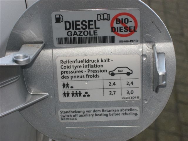

    FISH- What did you find on the VW Website?
    The photo is of the Fuel Flap on a 2008 Hi Spec VW Passat. The current VW position on the use of Bio Diesel is easy to see.
    My previous 2004 Model was able to run Bio Diesel

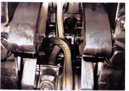

    And this one shows a denied warranty claim from running Bio Diesel.....:D
      30.1 KB
      1,224
