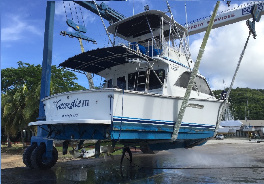

    down here in Trinidad the sea temps are quite high and we require a diver to wipe of the slime every two weeks. I would normally use a hard paint on my 38 ft sportfisherman and have had the paint last me 3 years between haul outs. The paint seems to wear away the most around the waterline above the chine where the sunlight increases the growth rate, hence requiring the diver to clean that area more often.

    This is why I always add a few (2-3) extra coats of anti fouling on the top foot. Not a lot of paint, doesn't take long, and as you said, that's the part that takes most of the beating, so you can scrub it a little more without wearing through just two or three layers.

    yea I normally add an extra 2-3 coats to the area above the chine, looks like I will have to add more next time.

    hahaha good one, nah its normal 3m scrubbing pad. like I said, cant really complain about my bottom paint lasting 3 years in the tropics

    The paint that I had on for the last 3 years was a Carboline hard paint sold by the local distributors here in Trinidad, not 100 % sure what exact product
    series. Unfortunately they stopped importing the hard paint in blue, and I did not want to go with black paint. So I have since reapplied a different brand of blue paint, and I will have to see how it holds up.
    I have attached a picture showing the condition of the paint after 3 years.
