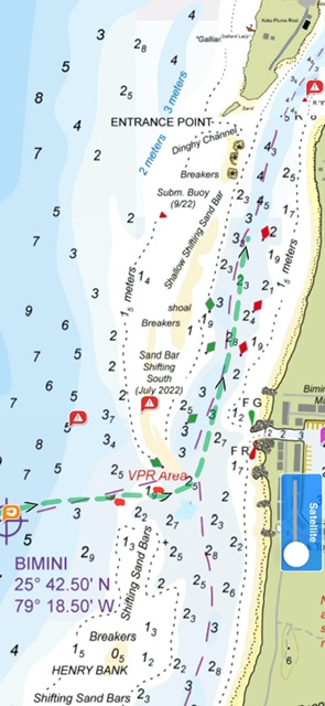

    If anyone is going to Bimini this summer, the buoys marking the entrance are off station
    you can leave the first to STBD as expected but you need to leave the second red very close to PORT. I passed about 10-15’ away. Then continue for about 200’ before making the turn north staying well away from the green which is almost dry at low tide.
    this will give you 8 1/2’ MLW
    green dashed line is my track, chart edited to extend the sandbar and position the two reds where they actually are
    or you can use the old range. I didn’t try it as I heard the range markers are barely visible.

    13,270
    Did you go in with the Big un or yours?

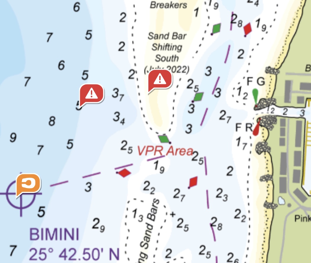

    Pascal
    I have Explorer charts on AquaMap and the markers are in different positions - see screenshot. Do you have any idea why this could be? I just updated the charts. What software are you using?
    Thanks.
  13. Pascal
    8,474
    Same, latest explorer update on aqua map but I mentioned in my post I edited the screen shot of the chart to show the current location of the reds and the growing sandbar
