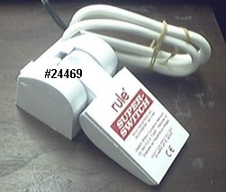

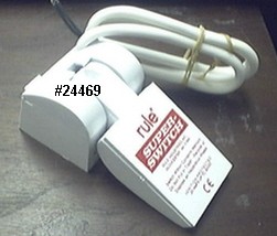

    If your bilge pumps use typical float switches, Your looking for a similar switch near by, like on my Bertram.
    The alarm float switch is near by but mounted about 6 inches higher than the pump float switch.
    This is the most typical factory install on our old boats.

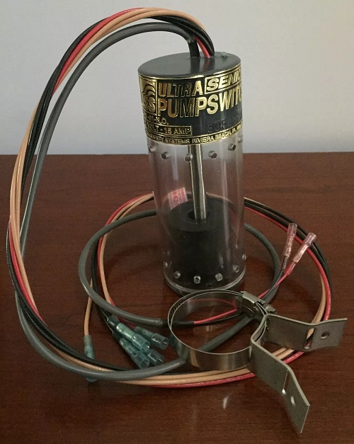

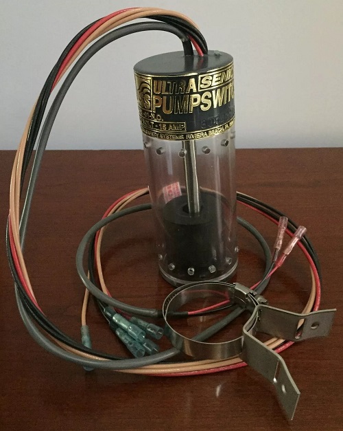

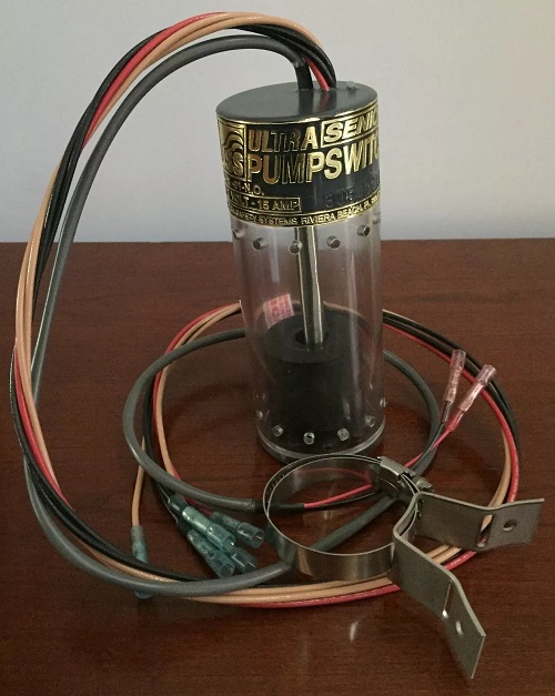

    If your bilge pumps use the Ultra SR float switched like this one, the alarm switch is built in (Not in the JR switch).
    These detect and keep track to ensure the pump is winning the bilge water war.
