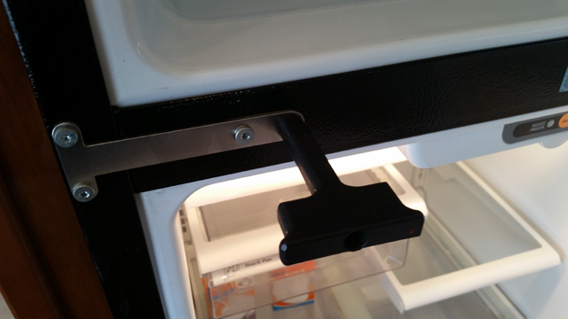

    I saw this on a GE refrigerator aboard a 580 Meridian motoryacht. I looked and searched for a source with no luck. Very clever - close the doors and turn it and both refrig and freezer doors are secure.

    That is pretty good. Thus far the best thing I can find is possibly a taylor made turn lock made to close windshield pass thrus but that might be able to be modified for my purpose. I know there's a better solution, just haven't found it yet.

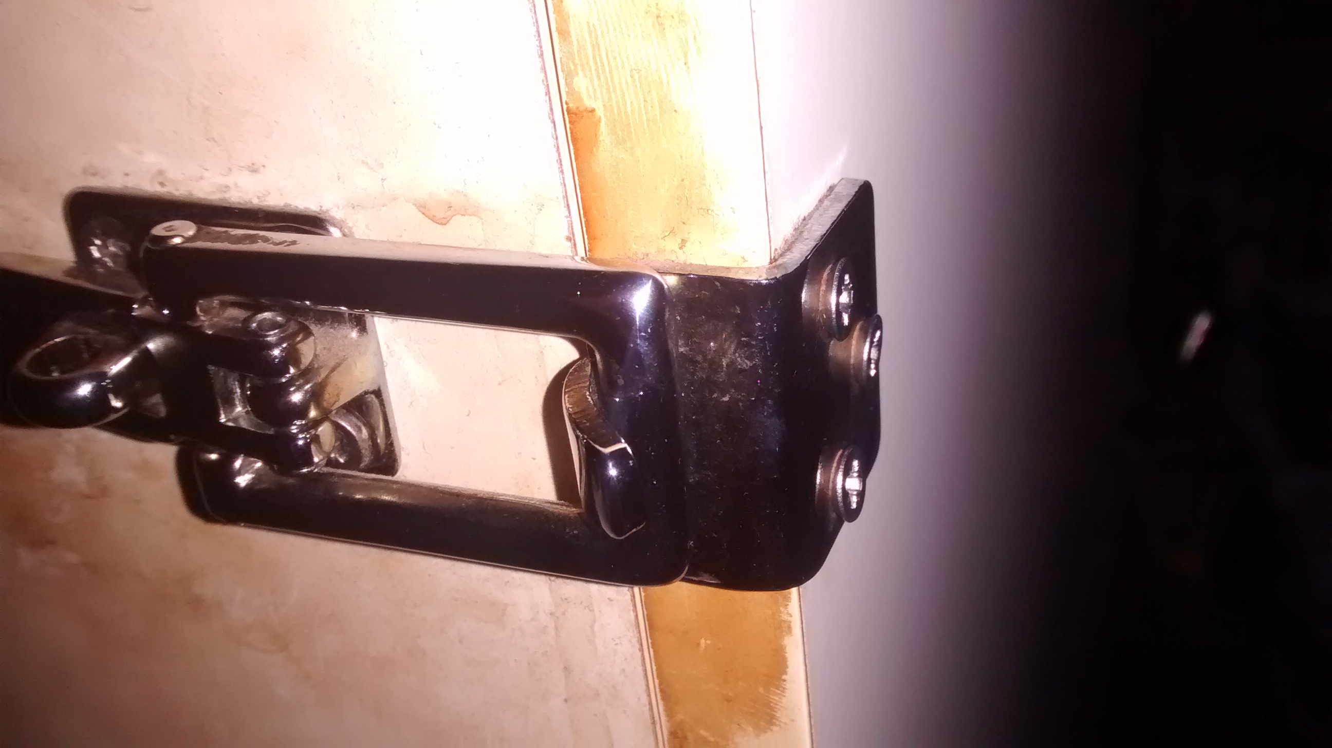

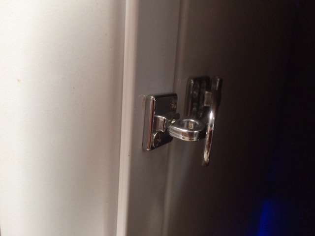

    I have 2 chrome strap hooks fasted to the side of each door. they work quite well. Hook is screwed to the door. the eye is screwed to the edge of the refer body

    Bill, perfect. Only problem is I don't seem to be able to find anywhere that sells them. Kind of looks like Stealth won't sell to an individual.
